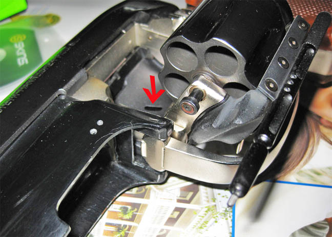

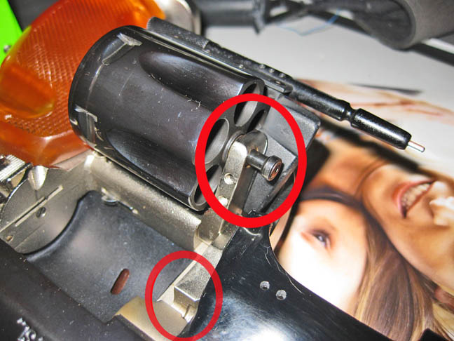

Well I've seen the inside of what has to be the best PKD that exists, and it confirms my contention of the absolute importance of a front cylinder locking system. I don't know the gunsmith who did this work, but he's first class. If you look at the attached photo, you can clearly see his workaround for removing the stock Bulldog extractor and cylinder locking sleeve and make it possible for the cylinder to swing open without taking the Steyr magazine off. This pistol is made from a real Steyr SL, not a casting of some sort. The steel is good-- not a lead/tin or potmetal alloy. The machining work is superb. The round extension placed on the shortened extractor rod will lock with the frame.
Doc has to admit, this solution is much more elegant than my idea of using the "Weaver" screw to hold the swing arm. In fact, I may try ordering a few extractor rods to play with and try this-- they're cheap from Charter Arms parts dept.
But the key thing is that that you don't turn a PKD into a shooter by cutting off the end of the swing arm, as is done in the replica pewter kits. People who saw this mod on a toy and thought it might have worked on a real gun should never even think about experimenting with a pewter shell or a chopped up Steyr and a firearm. The pewter kits are toys. A gun is a gun.
(BTW, image used by permission of the gun's owner.)

PostPosted: Sun Dec 07, 2008 1:39 pm    Post subject: Reply with quote
Very Happy I was just editing my previous post to address the blank composition issue. I know how to do it from my years as a pyro.
Re porting, probably not necessary for the gun in the pic (but I think it's there anyway-- safety first). Everything attached is steel to steel, not pewter or pot metal to steel. It has a real Steyr, real Bulldog, and a bunch of what look to me like superbly done custom machined (presumably steel) innards. However I think I see a venting port in the pic posted at the beginning of the thread. Look to the left of the lower red circle. That seems to be an oblong hole machined into the right shroud, but I don't have external shots of the right side exterior. That little oblong cut also shows in another photo posted below. Looks also like it vents above the right cylinder shroud. I think I see also see venting at the forward left cylinder but don't know for sure.

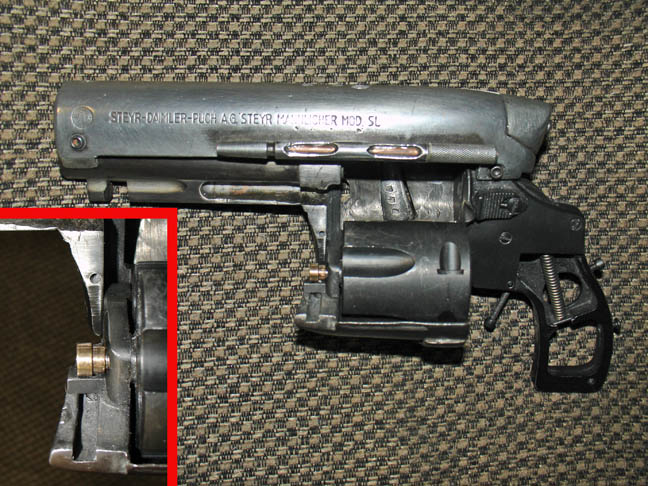

This evening, I'm making a mod (as seen in the photos of the super quality gun) by using a similar process for shortening the extractor rod so I don't have to remove the magazine housing, yet still get solid lock between cylinder and barrel. If it works I'll post pics. If not, I'll send Charter Arms a few bucks and buy a new extractor rod. Confused

PostPosted: Thu Dec 11, 2008 6:09 am    Post subject: Reply with quote
Well I did it. No longer have a push rod extractor, but that's no big deal. I shortened and threaded the existing extractor, then made a brass bushing. Using a dremel, I took out metal a little at a time until I had a secure fit, and of course, retained the cylinder lock function.
I'm in the process of completely refinishing the gun, but thought you might want to see this. I don't recommend doing it. Big pain in the ass to do, and I had to build a jig to reassemble the cylinder with its multiple springs and tiny retaining pin (which passes through three parts that have to be in perfect alignment!)
However, the end result is that I no longer have to pull the magazine to reload.
