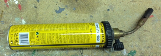

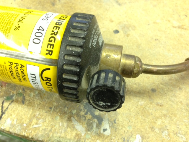

I have a blowtorch with a similar valve fitting which fits the bill.

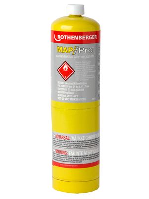

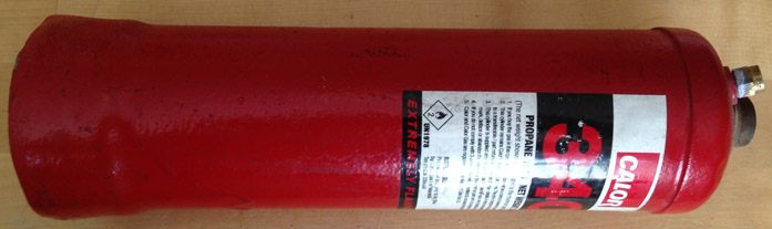

The can I have for it is a disposable can. I think what's needed is a more heaven duty can like these modern propane cans.
Trouble is these have a larger thread.

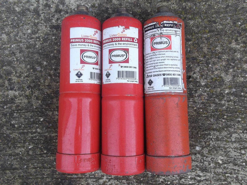

Now I've managed to get hold of a refillable 'Primus' canister which are more heavy duty and around in the period the film was made (I think). Typically they have a different fitting again.
There are a few different designs. I think the one I got looks close with the flared end.
What I need to find is a Primus valve fitting with a plastic knob like this one. Most of the ones I've seen are all metal.

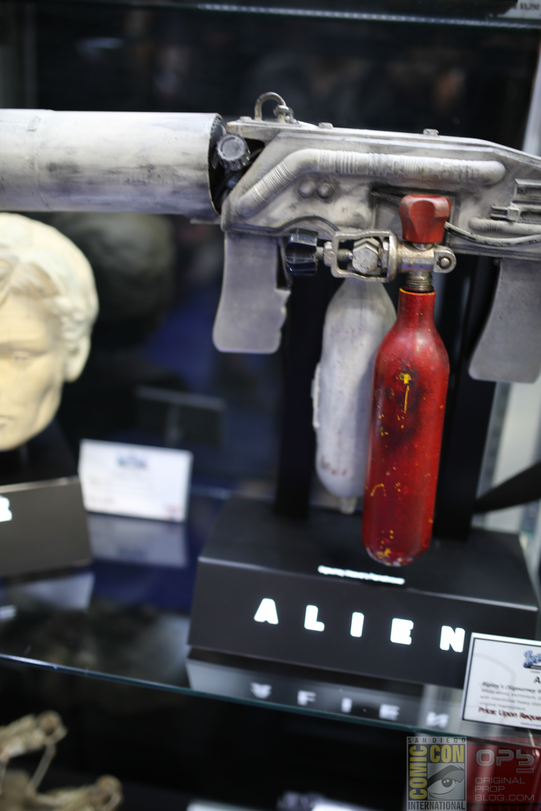

Talking about pics, these were posted on the Original Prop Blog today, it looks like the screen used flamethrower is currently exhibited on the Propstore's stand at Comic Con 2013...
Hope it'll help... at least on the (future) paint job !

I thought Comic Con may throw up a few more photos of the Propstore flamethrower but its mostly been covered on you tube. Maybe they had a ban on photographs!
Apart from the video Fred mentioned, there is this interview with Stephen Lane.
http://www.youtube.com/watch?v=eITMHkob-Fs
Here you get some close ups. Mr Lane talks about the unit, how it's had some restoration work done on it and authenticating it from Pat Lowery's photographs.
