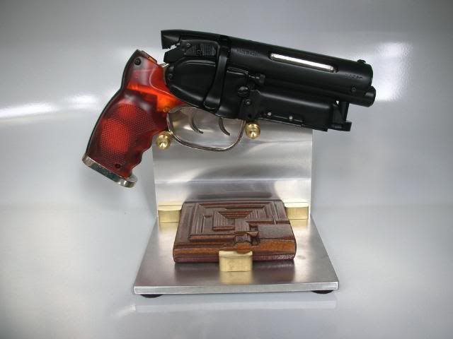

I've been working on designing a blaster stand worthy of the famous Blade Runner blasters. With the amount money folks are spending on the blasters I thought there might be a few who felt that a high end prop gun deserved a high end stand.
This particular stand is what I refer to as the "Tile Stand." It uses a licensed Ennis House tile as designed by FLW. My other design is still in progress, but will use one of the police badges or emblems on the upright, and have a shallower base.
The stand is all aluminum with brass pieces used as gussets and to retain the tile. The pegs are custom machined brass with lathe cut detailing and have a "relief" cut into them to center the gun and keep it away from the aluminum wall. No glues, everything tapped and threaded for screws.
If you want to secure the gun to the stand, simply use some coated stainless steel aircraft cable (very small diameter) and loop it around the gun and drill a hole in the stand (hidden by the gun) to pass it through. You can then secure it with loops and a small lock, etc.
I don't know if there is any interest in these at all, but at least I have one for my own blaster. I am awaiting my Worldcon blaster and hopefully the Second Version of my stand will be finished when it arrives. If I could sell these for $95.00 each plus shipping (TILE NOT INCLUDED) would anyone be interested? I can include the tile, but it is an additional 40 or so bucks so I'd rather give you the info on how to order your own.
Anyway, here is my 1st Version Blaster Stand with glazed ceramic tile:
