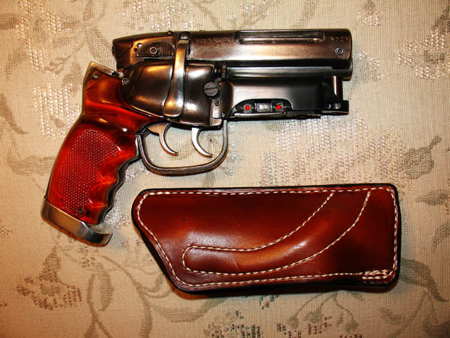

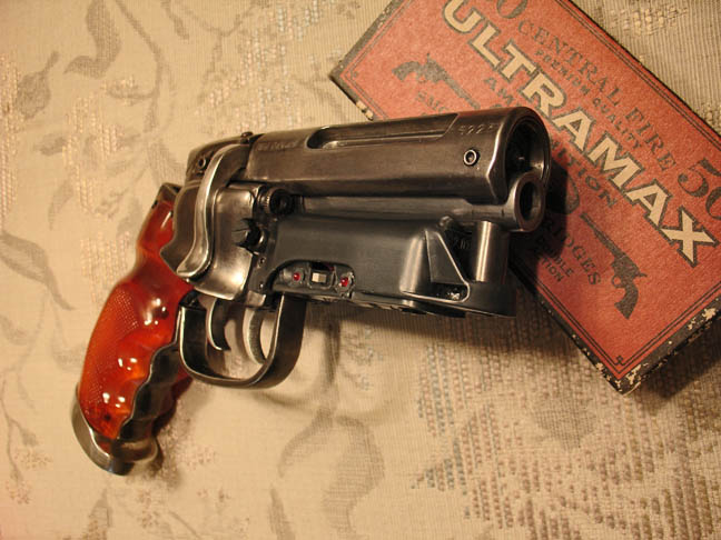

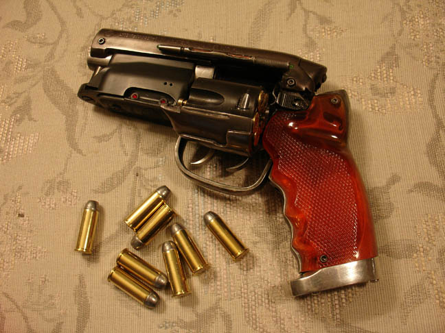

Well, it's a wrap. As far as Rich Coyle and I know, this is the only operational blaster ever made from one of his kits. As you can see, a few liberties have been taken with the overall design of the gun. It's a bit shorter in order to use a factory 4" barrel. Shortening the overall length involved a number of steps too tedious to describe here. The "laser sight" has been mounted to the Steyr receiver, not the left Steyr cylinder cover. This is far stronger, and allows the gun to be safely placed into a spring clip leather holster (the holster in the pics is one of Phil's (http://www.steinschneider.com)-- I could have made my own, but at $130, this is damn cheap for a custom holster, and well worth the money in relation to one's own time and effort to form the leather.) To vent chamber gasses generated between the cylinder and barrel, I added a hole in the left cylinder shroud just above the second hex bolt; it angles into the cylinder chamber. To avoid having to remove the magazine housing for reloading, I made a brass bushing that I threaded on the stub of the extractor rod. This allows the cylinder to safely lock into the aligned position when firing. The red LEDs in the magazine are operational, but I decided not to activate the green LEDs in the laser sight. For one thing, they're never seen lit in the movie. For another, drilling holes for wires in the brass tube in the center of the pewter casting (Coyle's system-- I don't know about other replicas) weakens it, which you don't want to do if you plan to holster the gun. The finish I decided upon was a chemical blacking that I then rubbed out with 0000 steel wool, giving the gun the look of worn steel. To stay in character, we have to assume Deckard had a gun that he lived with intimately. He'd be able to take it apart and asemble it in the dark. It would show considerable holster and handling wear-- he was considered the best of the best, which means he used it often, and practiced with it at the range. It would not look pretty. It would look a bit worn, like its owner, and very dangerous. At a later point I'll drill out a hole in the center of the front to allow passage of a laser. I have one that will fit inside the Steyr shell, so I can point-on aim the gun. So maybe it's not quite a wrap. But it does shoot those bullets shown in the pictures-- I know this for a fact because I've done it-- although in the future, I'll probably just use .44 special handloaded blanks. Blanks make a lot more flash/bang than live ammo, and I guarantee mojo .44 caliber blanks being fired will make the hideously expensive Asian BR pistols look like Mattel greenie-stickum-caps guns. I had to buy more screws and chemicals, so total cost of project is now up to $675. I still claim that this is the cheapest firing replica ever built. It doesn't take a pile of money to make a working gun, just a little dementia. Watch for the You Tube of it firing flash blanks, coming soon to a computer near you. BTW, the last photo is some of the left over or sliced and diced bits of Coyle's and Charter Arm's original stuff. For sale cheap (just kidding-- it's now in the trash).
Lastly, this entire project was done with a drill press, a dremel tool, and hand tools. I don't have a machine shop, though I'm thinking about buying one of those small metal lathes and a milling machine... if I ever have the money. Confused

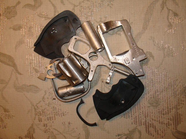

I'm not sure what to call it either. The trade-off in terms of length was strictly dictated by economics. You can buy the 4 inch barrel inexpensively and off-the-shelf from Charter Arms and slap it into the more common 2 inch barreled Bulldog. The Bulldog barrel has one start point in the threading, so you can't put it on wrong, nor do you have to do machine work to the frame. At most, you'll have to reset the cylinder to barrel gap if it's too tight for the cylinder to easily rotate. Most gunsmiths have a jig for changing a standard pistol barrel, so if you're not comfortable doing it yourself, you can pay ten or twenty bucks to have it done. In hindsight, I probably could have bought an appropriate .44 rifle barrel blank, cut it down into three or four prop accurate PKD length barrels, had a gunsmith friend of mine thread them for a Bulldog, and sold the extras. I just didn't want to get into economic committments and complications. But that's a very viable approach if there's a small group of people who want to build functional guns and split the costs. There are numerous sources for barrel blanks, as google will show you. The one drawback is engineering the attachment points to connect the barrel to the Steyr receiver and lower Steyr magazine housing.
I should also mention to those who are willing to cut up a real Steyr (and you can't use just any SL, you need a 4 digit serial number model), this is probably the best approach for a rock solid functional PKD. But plan to spend a thousand bucks or more for the gun, and then ruin this fine rifle with a hell of a lot of expensive machining. Also, you need a gunsmith who really understands the safety issues involved in mating a Steyr to a Bulldog.
So far the Richard Coyle casting has held up during firing. He uses a pewter alloy made of lead and tin. A bit soft, but easy to braze and solder for reinforcing and modifying. I think he still sells castings at www.racprops.com.
And used Bulldogs go for about two hundred at gun shows-- be sure to check it very carefully, because these are pistols that have had a lot of variations. The good thing about them is that they're stone simple in terms of taking apart. Charter Arms has a pdf with the exploded view if you're curious.

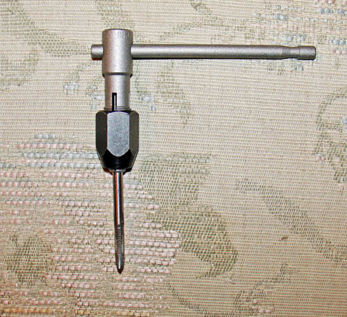

Lastly, while working on my gun, I realized that I'd be doing a ton of tap and die work. Initially I used one of those long handled taps from Harbor Freight. They're difficult to control, and since taps are hard brittle steel, it's easy to get a bad angle and snap the tool right in half. Which leaves the other half embedded in your work, and virtually impossible to remove. At Tacoma Screw Products here in town, I found a Vermont tap that allows excellent control, and I highly recommend it.
This gizmo will save you a lot of frustration and bad language.
