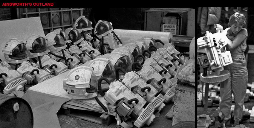

More pics...
PostPosted: Mon Jun 20, 2011 5:12 pm    Post subject: Reply with quote
Awesome stuff Fred.
Was looking for the Prop Store photo earlier but couldn't find it Sad
The top pic reminds me of the famous photo of all the Stormtrooper helmets piled up.

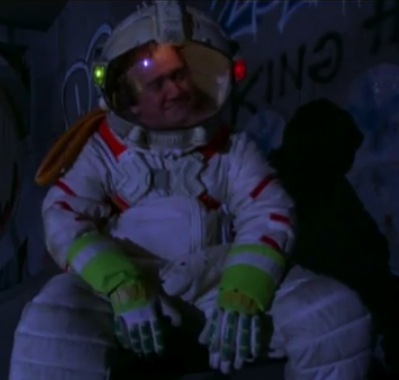

PostPosted: Thu Jul 21, 2011 11:59 am    Post subject: Reply with quote
The Outland suits have been used a few times in various UK film and tv shows in some form. Most notably Red Dwarf the cult 80's Sci-fi comedy series and Mike Hodges 1985 film comedy "Morons from Outer Space" which also starred James B Sikking from Outland? They also appeared in a short run British Airways commercial in 1989, generally just the helmet and backpack have been used, these helmets have been modified slightly.
Morons
Red Dwarf

PostPosted: Mon Jul 25, 2011 4:23 am    Post subject: Reply with quote
Your welcome Fred,
it seems Andrew Ainsworth who created the helmets allowed them to be used in several other film and tv productions........I recall seeing these in a childrens television show about 83-84? they had sprayed the helmets silver and added silly "deely boppers" ontop! I recognised them from Outland, but couldn't figure out why the films creators had allowed them to be used in this way? they then popped up in Morons 85, Red Dwarf 88-99, the British Airways commercial around 89 and a few others along the way.
SJ the plot of Morons entails the misadventures of four inept humanoid aliens, Bernard, Sandra, Desmond and Julian. whilst refuelling at a space service station, they accidentally leave Bernard behind, ( Mel Smith the guy in the suit pictured above ) unable to pilot the ship without Bernard they crash on earth, and become instantly famous superstars, courted by the media, despite being complete morons without a shred of intelligence or talent, they are assigned a manager and courted as the next big thing! Meanwhile the stranded Bernard, the most competent of the four is picked up by a passing alien pilot, the alien makes a pass at Bernard mistaking him for a female of his species, Bernard spurns his advances and is ejected from the ship into a passing planets upper atmosphere.....earth!
he survives a fiery re-entry and on landing in the deep south of America attempts to communicate with a post box/rubbish bin? before being locked up for vagrancy and placed in a mental asylum for claiming to be from outer space.....Bernard then sees his friends on tv and attempts to make contact! they realise that here on earth they are famous celebrties and decide to ignore Bernard and ride the gravy train! Bernard remains locked away!
It's been quite a few years since I last watched this, but it's a fairly enjoyable movie from the director of.....Get Carter! and Flash Gordon!
