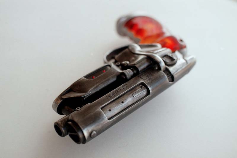

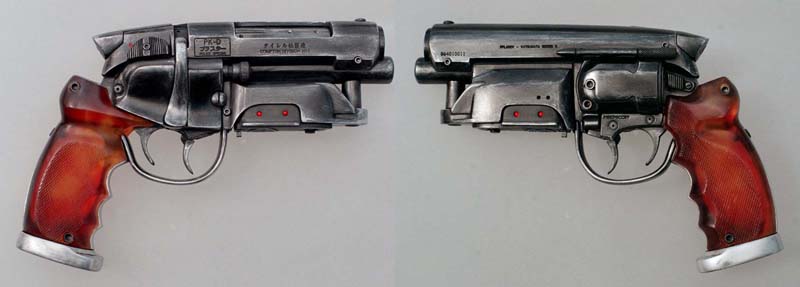

I thought I should add my newly completed PKD-1 re-issue to the comparison since there aren't any here yet.
Here's some more shots.
That is an EXCELLENT job.
Would you mind providing a few details on how you painted/weathered the piece?

Whoops. Those PKD-1 photos were a bit big. Here they are again at a more viewable size.
and more...
For the finish I followed Rick Ross's suggestions with a few variations.
First I sprayed a few coats of flat black primer wet sanding in between.
Then I applied black Rub 'n Buff with a finger over all surfaces I could get into. Finally I used silver Rub 'n Buff to simulate wear and tear and holster rub etc.
I did notice though that just the flat primer when sanded with 1000 grit came up to a very realistic looking shine. The black Rub 'n Buff gave an authentic looking gun blue shine. All finished with a bit of buffing with a dry cloth.
For extra realism I replaced all the molded screws with corresponding real ones. To give the blaster a more realistic heft and look, I drilled out the barrel all the way back and 3/4 filled it with lead shot.
Also I made the grips a bit more interesting by painting the backs with a clear reddish brown shellac and sanded bits of it off to give a bit of a tortoise shell look
An awesome kit in every way. Rick Ross is the Man.

Awsome! I do love seeing the PKD1 all gussied up. Great job.
