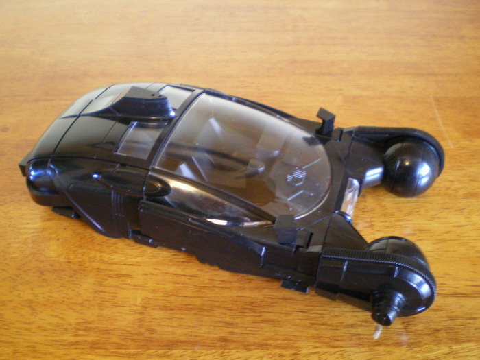

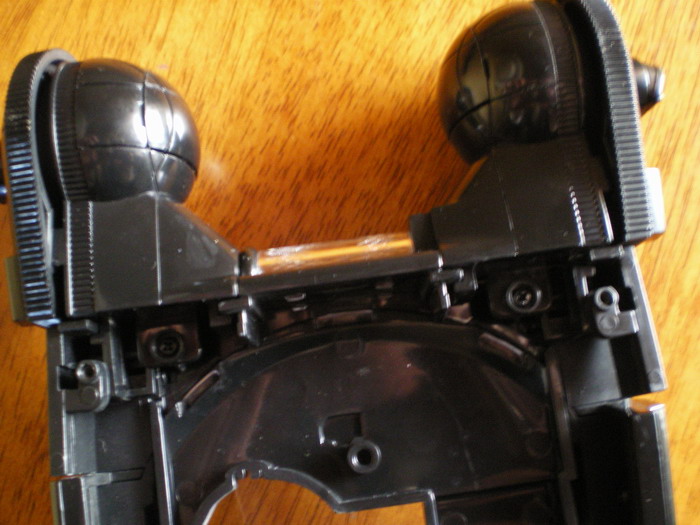

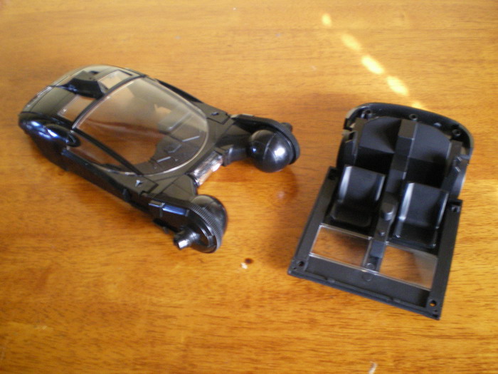

To begin, remove the 8 screws on the underside of the spinner. The two front exhaust vents will also have to be removed to expose front screws,
they just pull off. After all screws have been removed, simply lift entire top half of spinner in one piece............

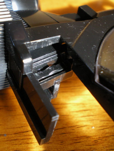

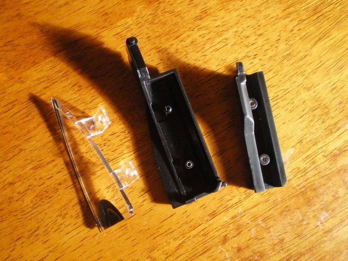

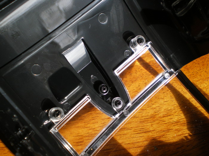

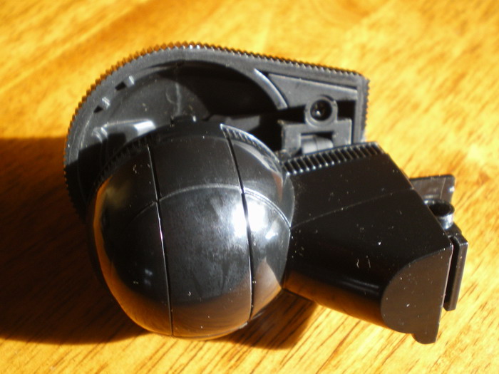

To remove the doors, gently twist each door out of its socket, they are not secured with screws or glue. Once the door comes out, a small clip will follow, the pic below shows the placement of that clip when it is time to re attach the doors. The door then breaks down into three pieces.....
Remove the 2 screw at the front of the spinner, then slide up and out both
front wheel bubbles. Then remove the 2 screws that hold the adjustable front wheel covers.

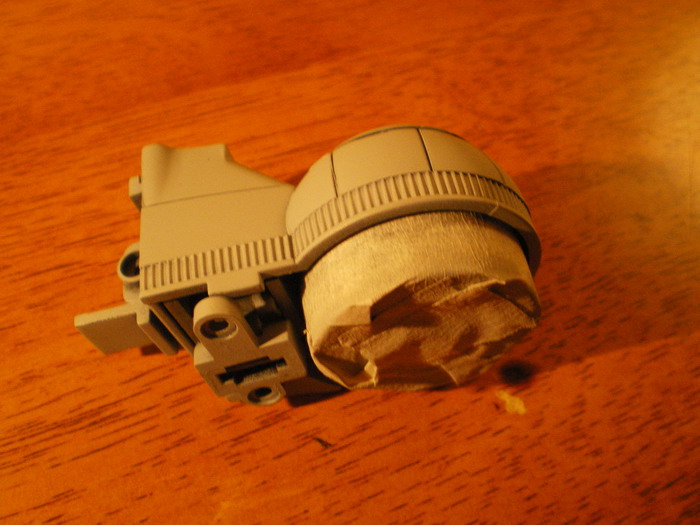

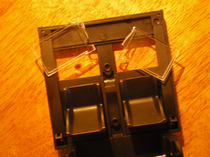

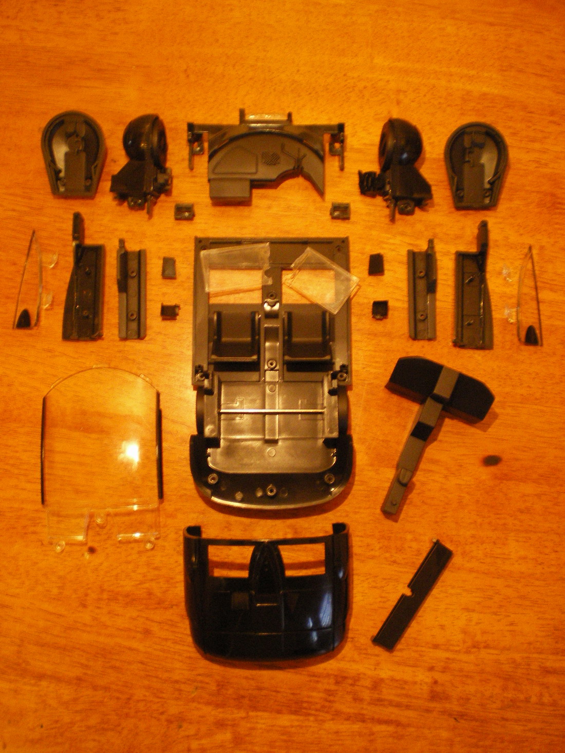

To remove the floor "glass" using a razor of some description, cut along the center of the glass repeatedly until you can place a matchstick underneath it and snap the glass into two pieces.........
This is the completed breakdown of the spinner and all that is reqiured now is to use masking tape in some areas, pics later, and its ready for painting..........

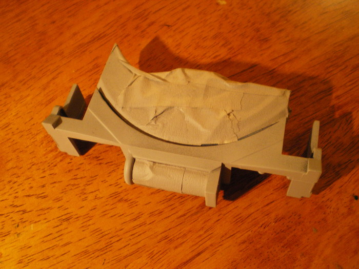

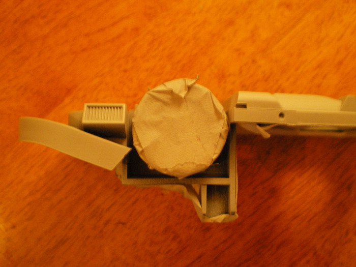

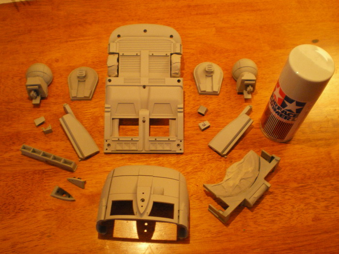

It is essential to prime the spinner before painting as the black colour will absorb many coats of paint with little result without it. The Tamiya light grey works best for me. You will need to mask up both sets of wheels
and the clear plastic front light window as this is easier than removing them.

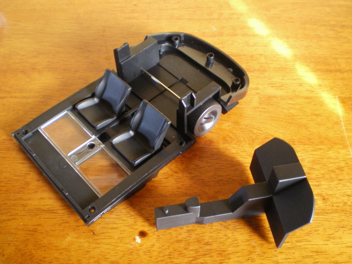

As most of the upgrade kit is concerned with the cockpit, a few items have to be removed from the medicom before installation can begin.
The two plastic seats will have to be removed, this is tricky to say the least as they are stuck in there good. I just rocked each seat backwards and fowards with increasing pressure till they popped. If your lucky enough to snap of the post as well your done if not, they have to be removed as the new seats need the space.

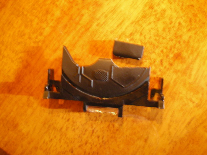

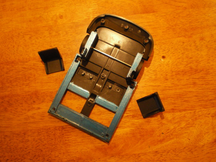

The existing monitor screen in the medicom will also have to be removed,
be carefull not to cut to much as i have as i will now have to patch it up somehow. The medicom centre console is also not required and the interior piece from each door is not required,

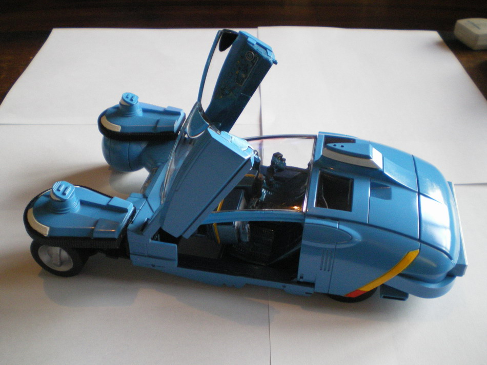

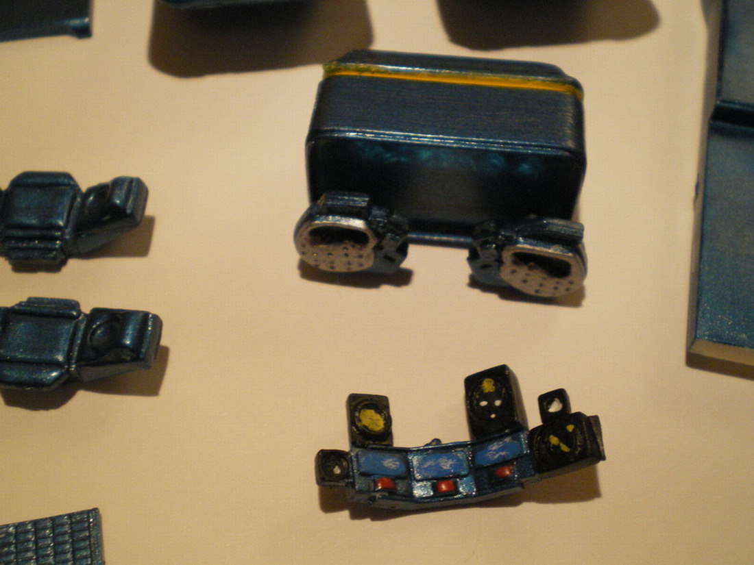

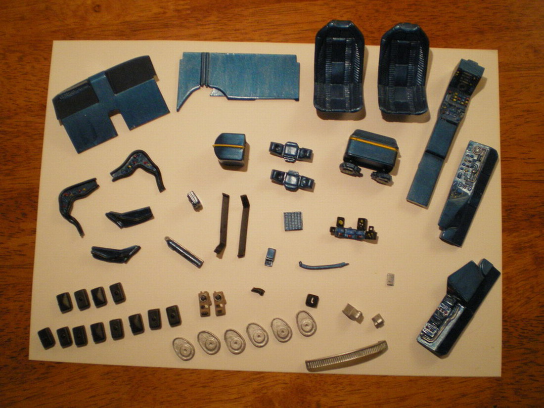

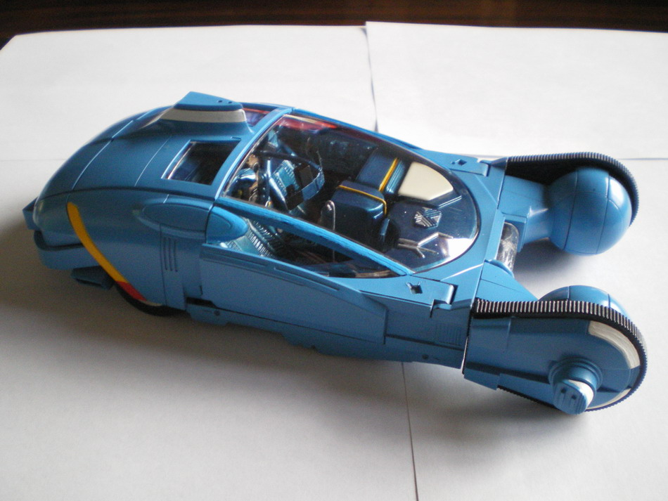

Here are the upgrade parts 97% completed. The blue i used is a Tamiya X-13.

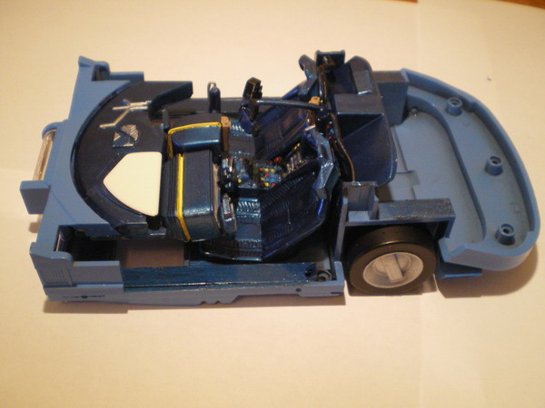

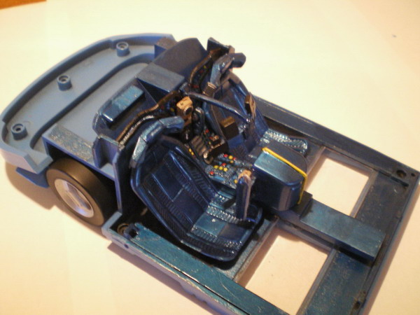

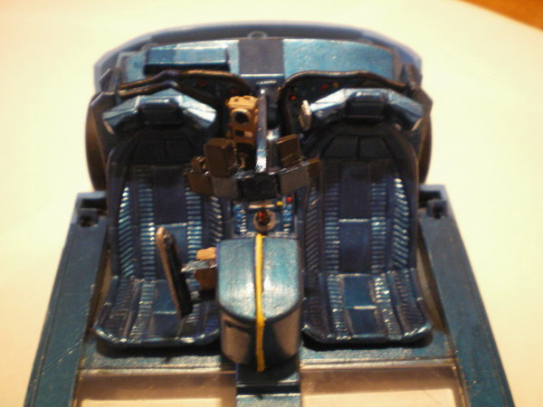

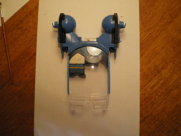

Here are some more progress pics. There is no specific order you have to follow when installing the interior except the clear floor panels, they have to go in first.
Now the hard work for me begins. The one thing that will determine
if the spinner has a practicle light bar or not are the tear drop molds.
The only option i have with them is to paint them with clear colour and that is notoriously hard to work with. If the clear doesnt work i will have to go with a solid colour which means no lights.
Ive made a start on the front light................
The last thing will be the decals. Never had any luck with them and am dredding this stage of the conversion...............
