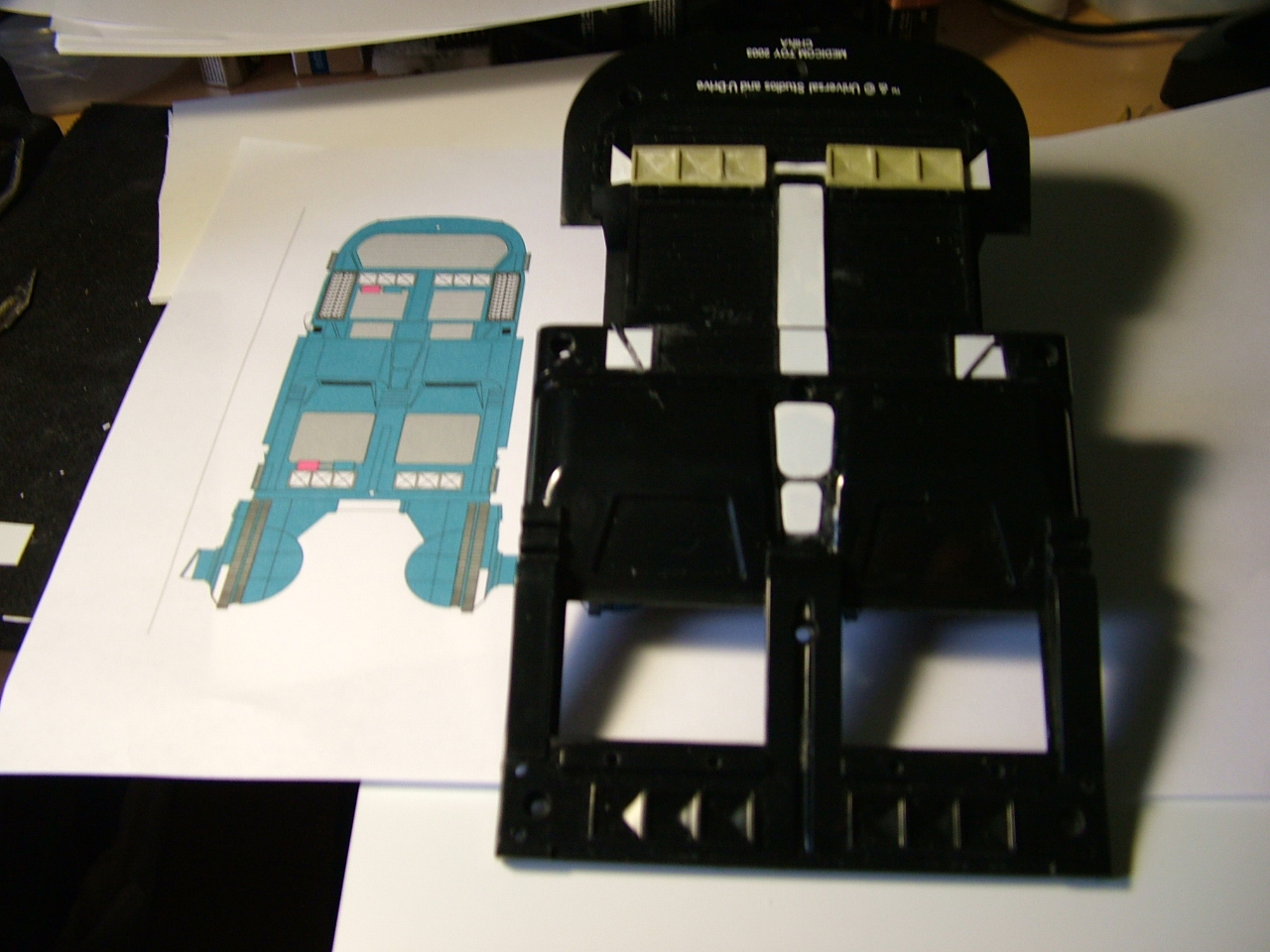

PostPosted: Mon Sep 07, 2009 3:11 pm    Post subject: Medicom base Photo Reply with quote
Hi Guys,
Sorry about the delay in replying real work got in the way I've uploaded a photo showing the plasticard additions to the Medicom base it's at http://propsummit.com/upload/665/dscf0673.jpg as I cant seem to add photos here - perhaps its me? basicall its making the Medicom car look more like the Spinner we know and love
I'll add more as I progressx with the build
Jonny[/img]

What is the picture you are using for reference?
Is it and others publicly available somewhere?
