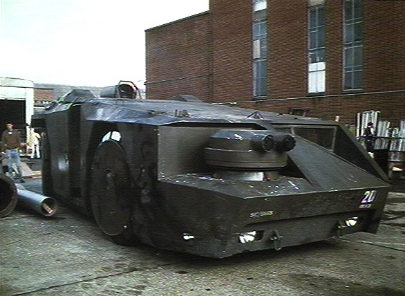

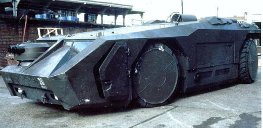

For protection during the crash scenes, a halfround cover was added over the spot.
http://propsummit.com/upload/696/apc00.jpg
http://propsummit.com/upload/696/apcleft.jpg
Posts: 9239
PostPosted: Sun Sep 11, 2011 6:22 pm    Post subject: Reply with quote
Thanks for those Bwood...now I remember Wink

Thanx Bwood and Joberg. As the cover is only seen in those pics, i believe it is not part of the design, and therefore not included in my APC kit.
