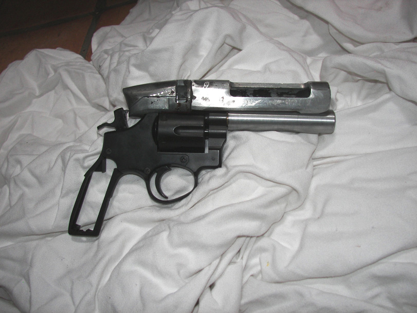

Here's a quick shot of how my HFC/UTG airsoft based blaster is coming along. VERY EARLY STAGE of machining and fitting just to let you know that I'm still on it. Missing from this shot is the plug I made to reduce the size of the ejection port and the cocking lever I'm whittling down from a motorcycle drum brake arm. At the moment I'm mocking up the Steyr clip housing out of ABS. I know that RUML is working on the same project, and if anyone else is interested, Hobbytron has the UTG bolt housing, handle, and endcap available for about $18 bux. That's really all the parts you need from the UTG rifle; just add your favorite airsoft blaster, mill them to fit like you like, and sink dozens of hours into it and, voila! You're halfway there! Here's the link:
http://www.hobbytron.com/M324AirsoftSniperRifleRepairParts.html
