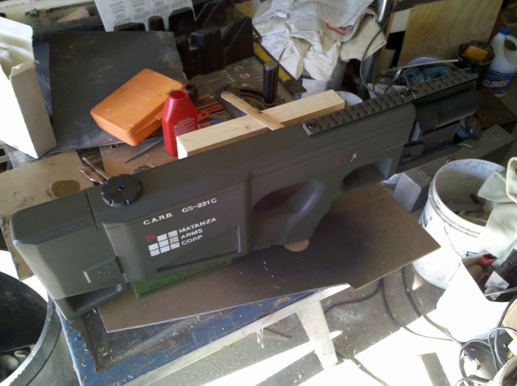

The parts have been given their base coat, and test fitted again. The fire selector markings were done using two small patches of white and red spray paint. Once those patches were dry, vinyl transfer lettering was put down to mask them off, then the main color was applied.
The main body was painted in a dark green using Krylon's camouflage paint. Oddly enough the flash on my phone camera seems to have turned it into a psuedo Bess Brown here.
After wet sanding I caught a break as the wet sanding left a bit of a grimed look to the parts. The Matanza Arms logo proved too finicky to get a stencil cut, so I cut white vinyl sheet down into the required size then added the lettering using the same transfer letters I used for the fire selector markings.
I'm currently debating whether or not to add more grime and weathering to the body. I think the logo's a bit too clean looking at the moment. There's still a few detail pieces to be added before the final clear coat and assembly. The magazine box graphics are still in the printing process and should be here in a few days.

Yeah I thought about going the route of putting down silver then painting over it, but from what I was able to gather about this gun, the main body seems to be some kind of composite plastic like they use on the AUG or P-90. So I decided to omit the silver undercoat.
Overall I'm pretty satisfied with the paint work, so I don't think I'm going to go overboard on weathering it. This is after all, not the proverbial AK-47 that someone took a dump into the breach and then buried in the sand for two months to prove it would still fire after that kind of abuse. Wink
I gave the markings a little going over with a sponge and some dark ink wash, that seems to have toned down the uber-whiteness of it somewhat. Unfortunately my phone flash tends to wash it out.
No flash
Worse comes to worse, I'll have to look into getting the logo done as a screen print or a decal and doing it that way. The initial tests I did using a stencil, the small grid between the squares let way too much paint get under it.

The top and bottom rails have been installed, the cocking wheel has also been installed. The only things that still need doing are the selector switches and the revised logo. Otherwise I'd say it's pretty much complete as far as construction goes. Time to track down an appropriate looking red dot scope for the top rail. I might also try the flip sights off my MP7 airsoft to see how they look on the top rail.
Rails installed
Barrel details
Knight Armaments vertical grip attached to lower rail
