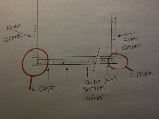

Posted: Fri Mar 15, 2013 7:59 pm Post subject: |
What proper said ...just don't use regular contact cement, it'll melt the foam inside.
I use either white glue or a contact cement without solvent (this is what melts the foam).
You can also cut triangles to put inside your corners (hot glue gun will do the trick to secure those fast and make your corners strong.
I don't know what kind of box you're doing, but you should cut the edges of the bottom in L shape (all around): bottom of the L is the paper alone and the wall of the L is the foam part.
So when you close your box, you'll fit that bottom inside the walls of your box.
There, I hope the drawing is helping  |

Thanks, proper and joberg! Great tips, and the drawing definitely solved my last couple of questions, joberg.
