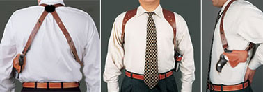

Here's a couple of approaches for the Hartford prop -
Perhaps a strap could be added, down to the belt on the left side (similar to the first pic), freeing the need for such an extensive sling on the left.
Thoughts?

Horizontal hanging pistol in the shoulder rig is really nice. I've always like horizontal stowage.
The holster itself I feel should incorporate a thumb break. It's still the best retention balanced with the fastest access. The design of the Snubby is such that a thumb break strap will sit nicely between the back of the receiver and the top corner of the gripframe.
Perhaps we could do a double duty holster, one capable of being worn on the shoulder rig, but also with a belt loop so it can be worn on a belt too.

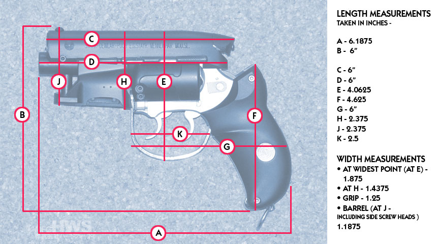

PostPosted: Sun Apr 14, 2013 10:31 am    Post subject: INCHING ALONG Reply with quote
OK, Proper. This should get you started. Using the image Andy posted earlier on your initial thread, I have overlaid a guide, along with measurements. Hopefully this makes sense. Being in the States, these are in inches. Unfortunately President Carter never got his wish of converting us to metric in the 70's, and I only had a conventional ruler handy. I assume you can easily convert.
A surprising number of measurements came in at almost exactly 6 inches.
As you can see, I've included a few widths as well. Short of someone over there loaning you their Hartford, I think these should help.
I've yet to assemble the Ross "Enforcer", and don't yet own a Goldberg.
Thanks - R13

I never seen the Hartford Snubby but my Snub Nose (Goldberg Arms) and Rick Ross' are definitly different enough in size so that a "one model fits all" holster is not likely to fit, or at least not fit well. My snub Nose is designing around a .38 cal frame and Rick's is based on a .44 cal frame (same as the hero, just shorter. There are other differences as well, especially in the shape and size of the ammo clip and trigger guard.
The dimensions given for the Hartford above make it larger in most dimensions, except overall length.

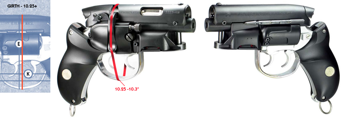

PostPosted: Mon Apr 15, 2013 12:45 am    Post subject: MEASUREMENT Reply with quote
Karl -
Here's the measurement. Just a tad over 10.25" really. This takes in the lever on the opposite side, not shown in Andy's pic.
- R13

That's exactly the right spot. This is entirely my fault, but I need the measurement in between the triggers, but not including the triggerguard.
I'm sorry, should have made it clearer. I apologize.
Karl
PostPosted: Mon Apr 15, 2013 9:33 am    Post subject: FOR GOOD MEASURE Reply with quote
If I'd been thinking, I'd have realized that .
Girth - 7.5"
- R13
