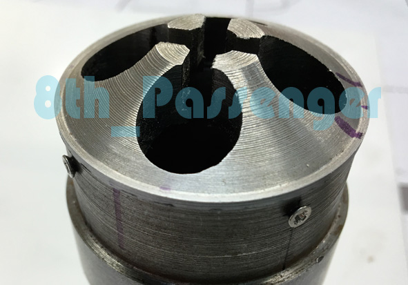

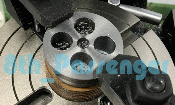

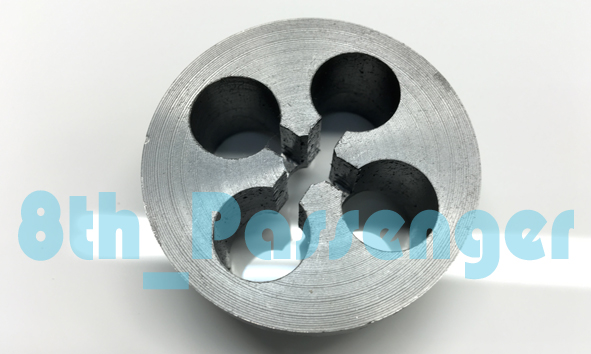

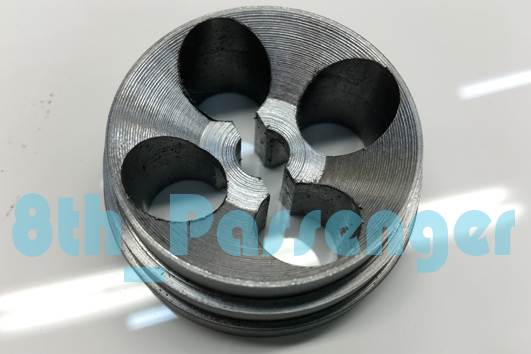

I managed to get the emitter end on the milling machine this week.
I bolted it to a rotary table and lined it up. Always stressful!
The machining went well.

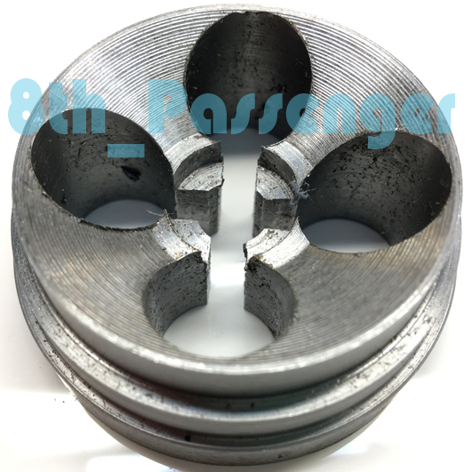

I added the cross slots.

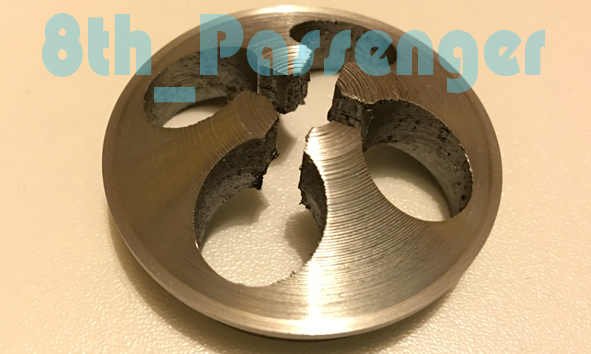

Due to rushing I missed the bottom off one of the slots.
Seen more clearly here on the underside.
So I used a milling bit in the lathe to add a recess.
This cleaned it up!
Strangely what I have made looks like a large tapping die!
Next week I hope to shape the front.
More soon.

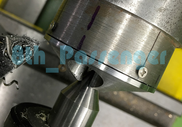

This week I turned the front face of the emitter.
I'll need to add some fixings to stop the end falling off. But this gives you an idea of how its shaping up.

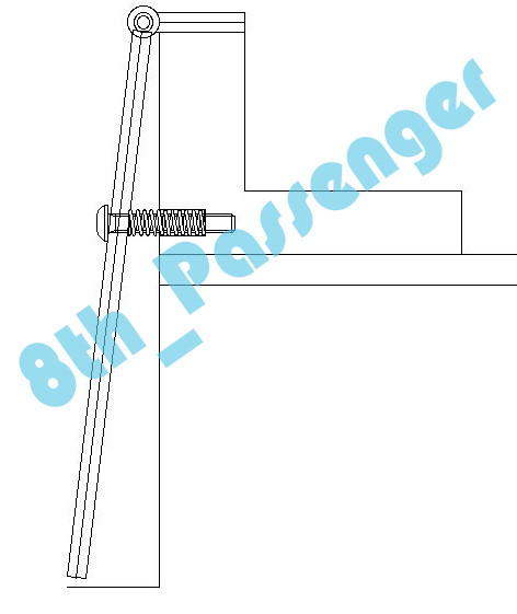

I decided I wasn't happy with my triggers. They weren't really strong enough in Perspex. So here's the start of a new design in aluminum. It will be simpler than the prespex ones (honest).

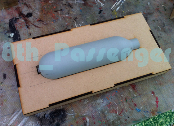

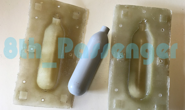

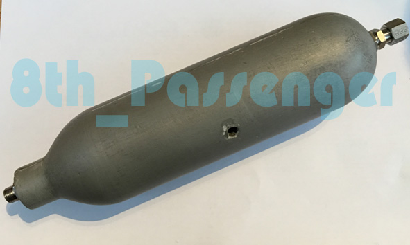

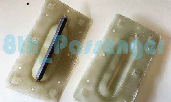

Now the weather has got warmer I have been able to tackle my fiber glass tank.
I dusted off my laser cut former.
And coated it with some packing tape before apply some release wax.
Its been a while since I have done any fiber glassing. But it went okay.
I test fitted the steel core in the mould.
I added some grooves into my steel core to grip to the glass and resin in the positive cast.
It came out okay. I used aluminum powder in the gel coat to help with the painting and weathering.
I drilled a hole in the side so I could pour resin in to strengthen the inside. So I need to do a bit more clean up before I can apply the final detail to the exterior.

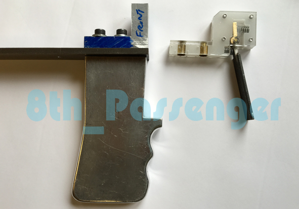

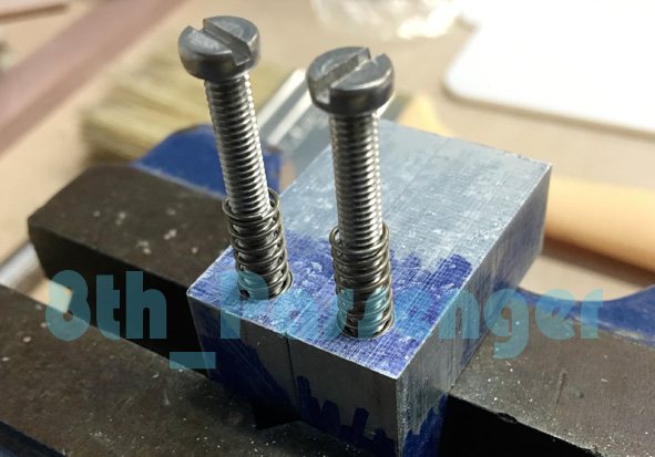

This is my simplified trigger concept. Using one hinge and one spring
I drilled a stepped hole in each trigger. One hole to tap (for the bolt) and a larger hole to hold the spring.
Like so.

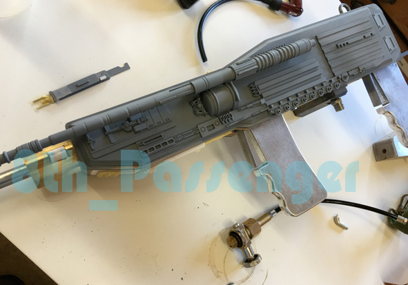

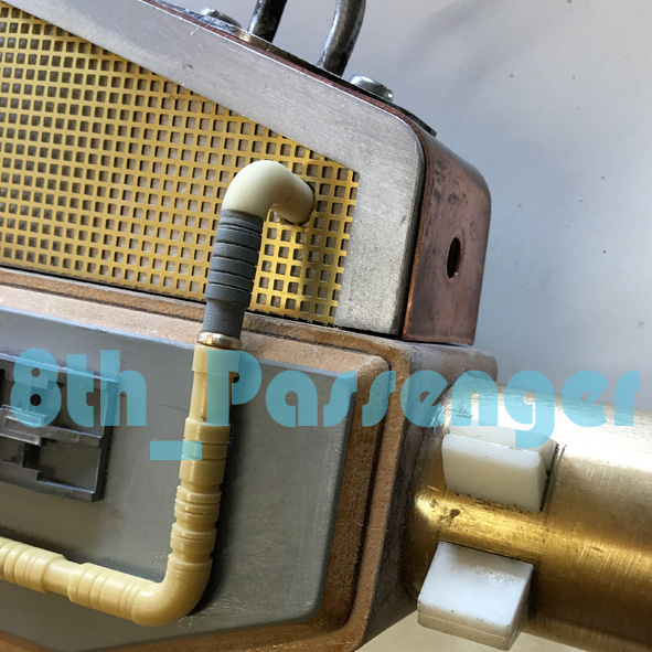

Here's the re-made trigger mechanism. I'm not sure if it's better than my original version but it works and is all metal. Which is what I was after.
I turned a brass connector for the pipe that goes into the top vent to give it some strength. The top bend I had to recast in white metal as the fast cast one (pictured) broke when I laid it down on that side.

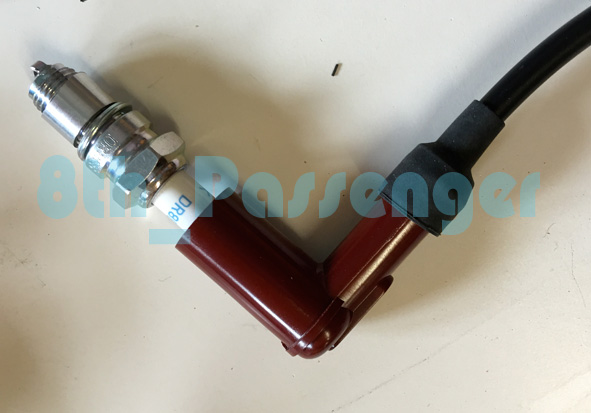

I thought I would see what a modern spark plug cap would look like. The design of these hasn't changed much but I couldn't find one similar to the reference. So this was a bit of an experiment to see what it looked like.
It looked okay but wasn't really cannon!

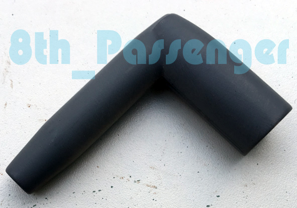

So from the reference I drew up this.
Realized here in two pieces of turned fastcast. I need to do a fiberglass mould and then cast it in a cold cure hard black rubber.

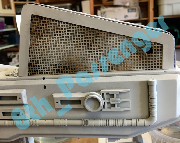

Here's a preview of how the painting is taking shape.
Left side with a coat of primer
I've sprayed the body with grey primer, a mustard colored primer, aluminum and finally white. The idea being I can sand back the paint layers and get different colors showing through. I will then add washes to dirty the white down.
This is the start of the paint job on the top vent.
I'm not trying to re create the paint job accurately from any particular photo reference. I'm just trying to recreate the feel of the paint job and put my own spin on it!
I'll just keep layering until I get the look I'm happy with.
