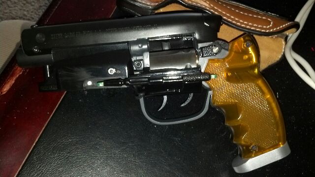

PostPosted: Sun Jun 23, 2013 11:54 pm    Post subject: I did it!!!! Reply with quote
I am extremely excited to announce that the .38 Charter Arms Bulldog parts I have DO FIt on my Off World M2019!!!!!! The modifications were fairly simple but did require some machine tools. Unfortunately, all the photos I took along the way ended up getting deleted from my camera somehow!? I'm not very happy about it but I can post final pictures and give detailed explanations ofhow I got everything to work!!! I will do so later as I am busy at the moment...
So glad to see the forum back in action!! It was missed greatly!
Again, I will be posting photos of the final product soon...the good news is, it works, it looks great and it adds some SERIOUS weight to the blaster!...

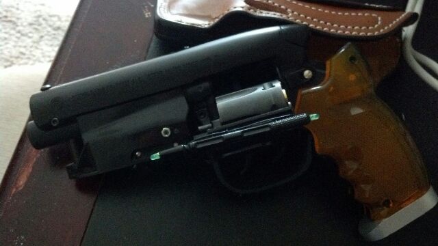

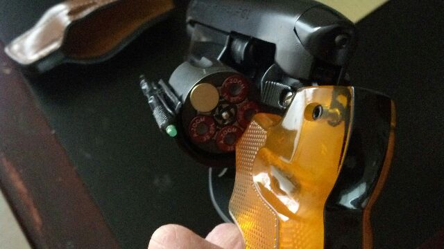

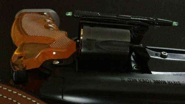

PostPosted: Tue Jun 25, 2013 12:13 am    Post subject: A few shots of the installed cylinder! Reply with quote
So..after some very quick modifications with a few files and s small hammer...I installed the real .38 caliber/ 5 round cylinder quite easily!! I will take the grips apart and show you the aluminum frame from the real Bulldog...it was a little work sith a few drill bits and a drill press...also you'll need a jewelers saw and a little patience... it took about 2 hours to do both modifications and it has added some Serious weight to this bad boy...next the grip color....and Oz's aluminum parts for the Steyr...it should feel pretty sweet by then!
So there you go for now...if anyone has any questions feel free to ask! Enjoy! Cheers!
