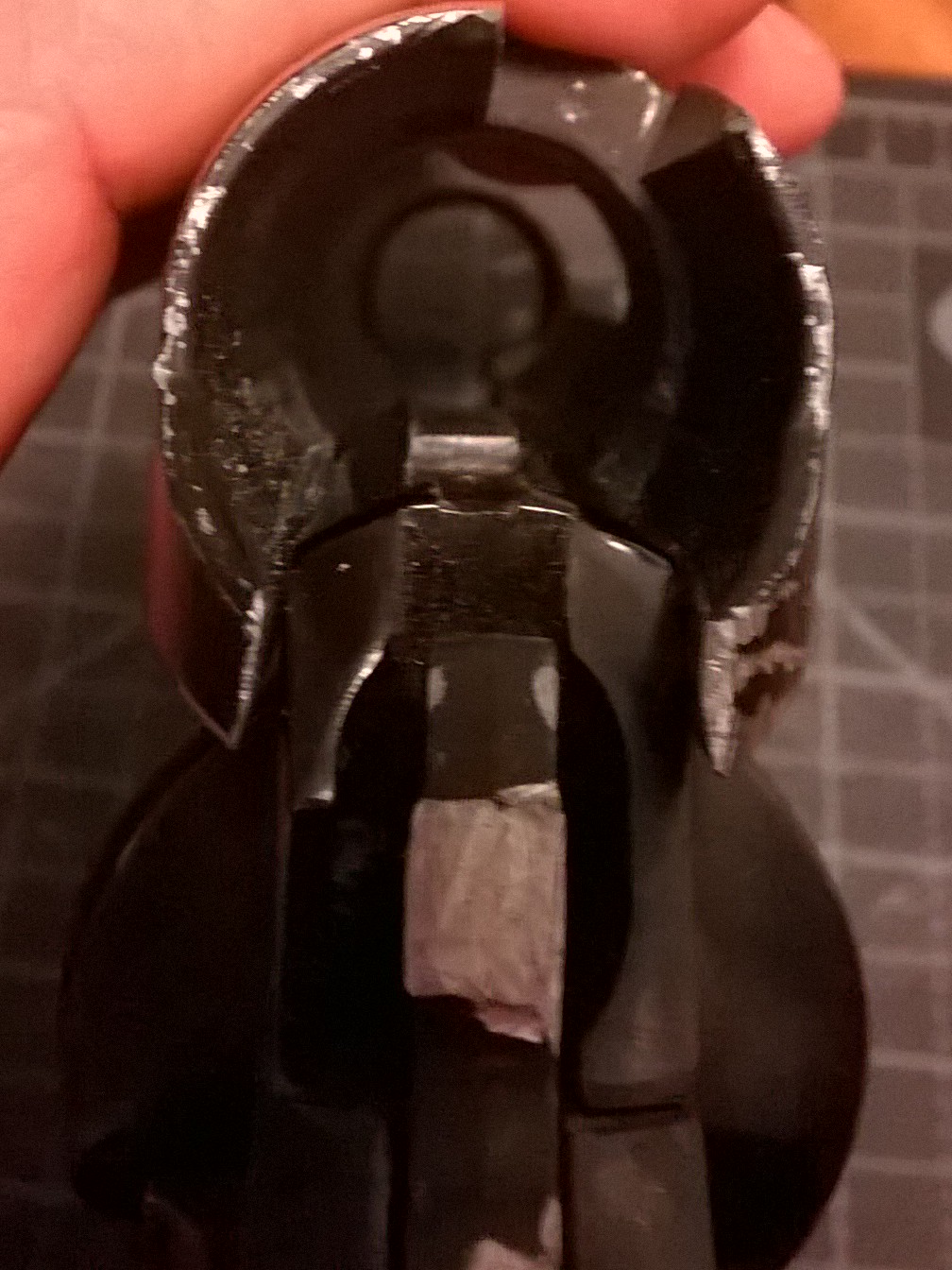

Over the weekend I picked up some super sculpty, and decided to build some custom side covers. First a foremost I am not a very good sculptor. I now have a great deal of respect for those who are. But with my favorite Zatoichi movie in the background I decided to give it a shot. The results are a little rough. I'll have to redo the leftside cover since it deformed during the baking process. These will be used as molds for the metal versions I'll eventually have cast and I think I should be able to refine the shape somewhat to get it closer to what I want.

I usually put a aluminium baking lid on top of my Super Sculpy to avoid baking it too much and too fast and to keep it from "moving", if you catch my drift Wink

I think what the problem was is that when trying to get the sculpty off the revolver it wouldn't come off cleanly hence the talc. I gave it another go and got slightly better results. We'll see if I can refine them into something I can use, otherwise the next idea is to use aluminum foil in between the gun and the sculpty. Hopefully that will allow me to lift it off cleanly without much prying, and therefore warping on my part.

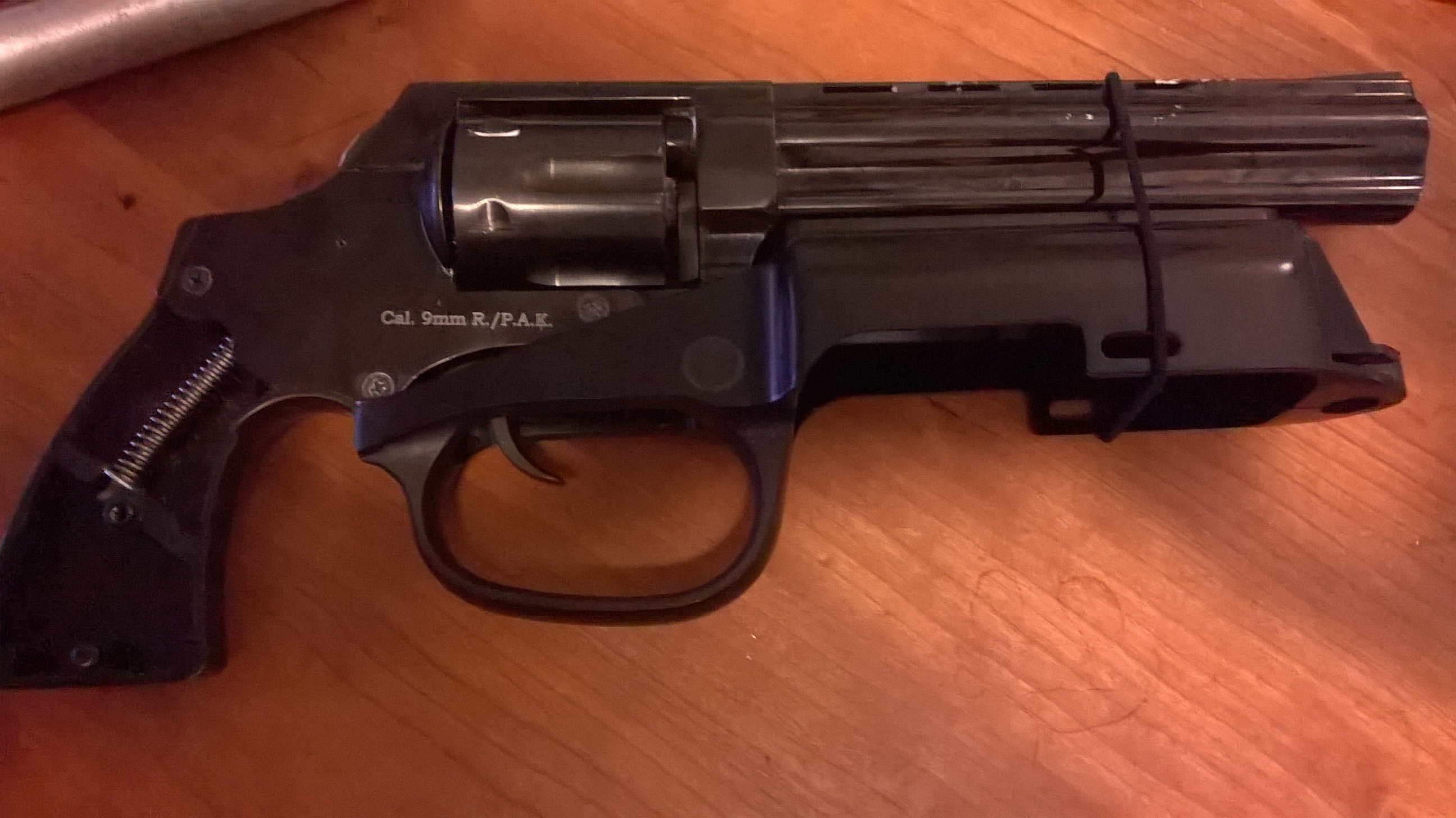

I made some progress on the project. I removed the revolver barrel and was slightly surprised to find that while pinned, it was not threaded. I have to assume they did this as a cost saving measure. This will lead to interesting decision for the new barrel I'll be putting on. Do I thread the revolver and the barrel, or stay with the pressed and pinned method?

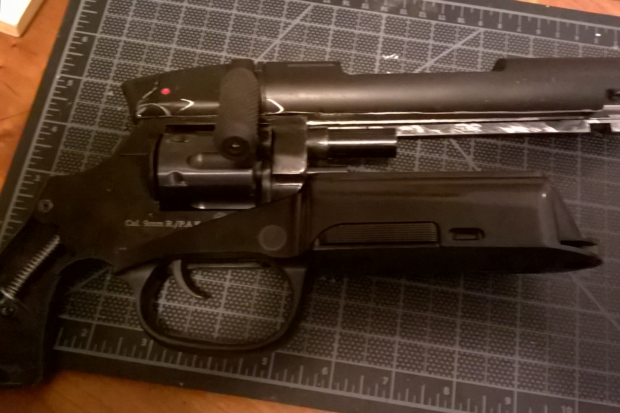

I also set about cutting the airsoft receiver. I'm not entirely happy with my results, I really wish I had access to a mill for that particular step in the build. I went ahead an purchased another airsoft rifle in the event I come across someone with a mill who is willing to help me out in the future. You may have noticed the receiver doesn't have the tabs at the rear like the steyr does. So figuring out how to mount it to the revolver will undoubtedly lead to more modification. I think I can cut a hole on either side of the receiver then tap for screws into the revolver frame and mount it fairly securely that way.
The outer grip frame continues to vex me. The amber grips I have seem to fit the OffWorld blaster fairly well. Revolver grip frame in the outer, not so much. I'm somewhat leery of cutting the inner grip frame for fear of losing mounting points.

Fitment of the receiver to revolver
Rough assembly minus outer grip frame, side covers, and barrel
