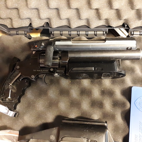

Quarantine has given me some free time. So between various long deferred house projects I've got this back on the bench.
I have the upper receiver where I like it, drilled and tapped a hole in the barrel to more securely fix it in place. I'll be using epoxy for the rest. I'll be doing the same for the ammo housing.
My big dilemmas right now are the grips and side panels. Since i have a Off-World grip frame properly sized grips are hard to come by. As are side panels.
I'll keep updating as things move forward.

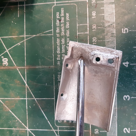

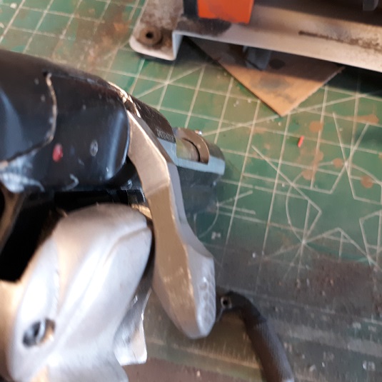

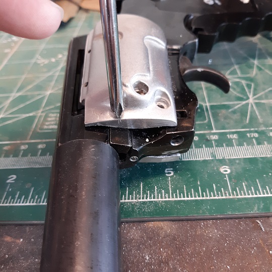

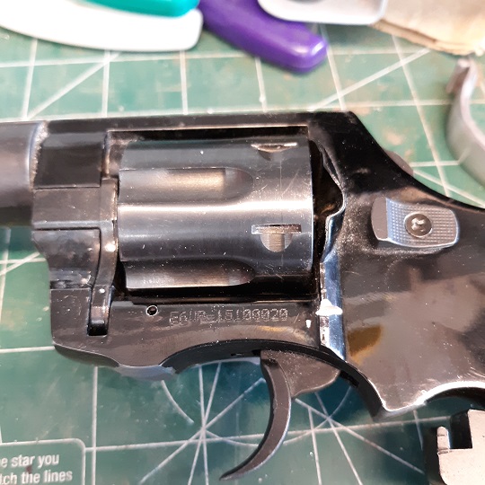

Here's my update regarding the side covers. I'm pretty pleased with how well they fit over the cylinder and attach to the frame of the pistol. Though considering how custom this build is turning out to be there's still going to be a lot of fiddling around to get the fit how I like it.
Here's the bolt action side I'm going to see what options I have for this while trying not to modify the opening too much.
Here's the cylinder release side. This has been a bit of a hassle. The crane arm on the revolver is too narrow to get a bolt in there comfortably. I also had to notch the frame just a little so the cover would sit more flush.
So I've been using a metal mix epoxy to build up the underside
There's a good amount of material here on the swing arm to get a good securing point. I'll change how the cover looks, but I'm willing to make that adjustment
Here's where I'll be moving the attachment to.
Once I have that done I'll be figuring out how to get the trigger guard attached. I learned the hard way propane and pewter don't get along. I think if I'm careful a hair dryer might produce enough heat (fingers crossed) so I can adjust the guard to the end of the frame.

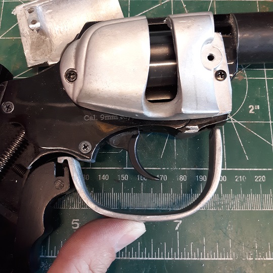

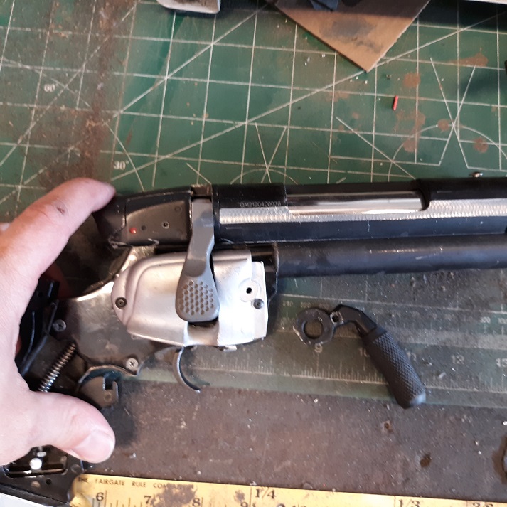

Getting closer now. I found some aftermarket arisoft bolt handles and decided to see if they might fit better.
Not quite a perfect fit yet...
And roughly assembled, here's my first attempt at a trigger guard.
full tilt boogie baby
Posts: 9240
PostPosted: Thu Jun 25, 2020 12:21 pm    Post subject: Reply with quote
Yep, that bolt handle will be a challenge for sure. Maybe modifying the cover plate? Your call, of course. Apart from that; it's looking good!

PostPosted: Thu Jun 25, 2020 3:20 pm    Post subject: Reply with quote
I was really tempted to change the opening, but I'm hesitant to modify the side cover since I only have one and it'd be a hassle to replace if something went wrong.
