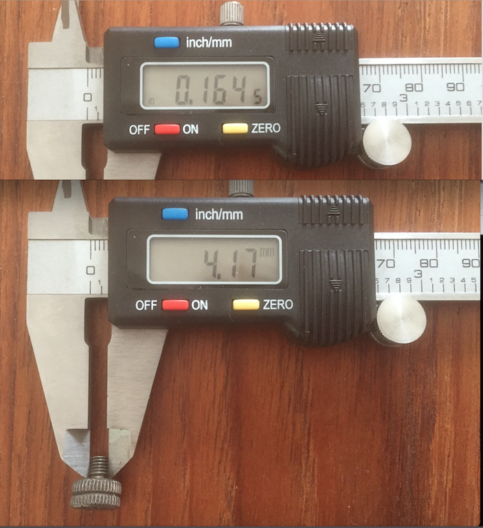

I wanna use this real vintage weaver knob in my new blaster build...
But I need to figure out the drill and tap size for the thread in inches...
I got these measurements but apparently I don't understand the different tables online... can any body help? I need the correct drill and tap size in inches...

Problem is those numbers do not match up to any real size or thread.
.1645 the closes is .1614 = 1/4 inch or .1654 which = nothing or 4.2MM.
4.17MM is that...
So the closes is .1653 inch 4.2mm is for a 5mm-0.90mm
OR under sizing it, the next screw below the above is: DRUM ROLL:
10/32 tap drill bit #21
AND that is what I use for those screws.

Thanks again, Rich Very Happy
I'll go for the 10/32 tap drill bit #21....
