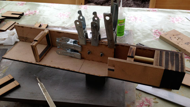

I'm treating this build as a mock-up/ prototype. At the moment I'm limited to machinery so I can only progress so far before I will have to stop.
Here's the build so far.
The main body is out of MDF and the grips at the moment are in acrylic. I worked out some cutting paths from my plans and had them laser cut.
Laser cut parts
Here’s the basic main body going together.

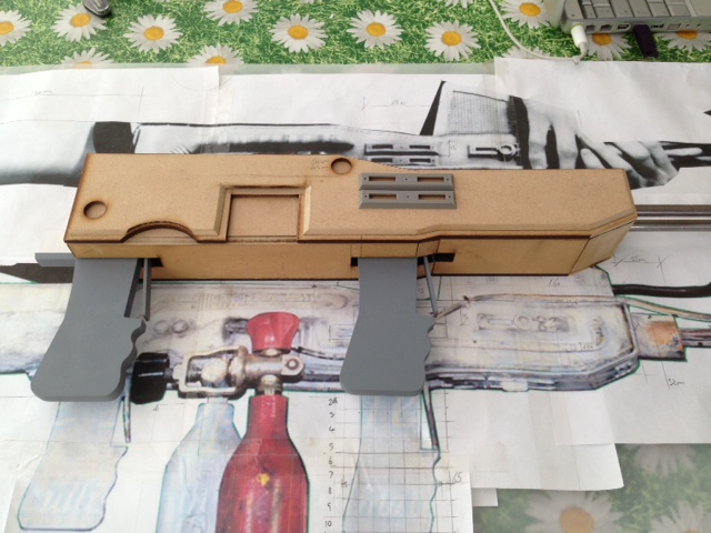

And here, a bit more fleshed out, against the enlargements.
My first goal was to get to the stage illustrated below and then decide if I need to adjust things.

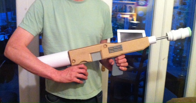

So my conclusion at this point is my unit is too small. I don’t think it’s just a matter of uniform re sizing. I think I have to adjust certain area’s, which don’t look right. But I do feel the overall length will have to grow. I think the Profiles In History sizing is too short (or that particular version was short)!
I’ve taken the picture of Parker below, who according to the web stands at 1.9m tall. At 190mm ‘on screen’ Parker’s flamethrower, which is almost vertical, is about 88mm tall. Making the actual size about 880mm long.
Then with the photo of Ripley. I know the Weyaln–Yutani patch is approximately 3” across. The patch fits into the length of the flamethrower about 11.5 times making the actual length about 875mm long.
So its back to the drawing board!
Comments welcome.

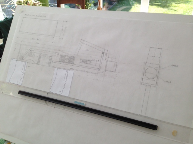

I decided I would literally go back to a traditional drawing-board. I like drawing in a CAD program usually. But I really need to see it full size now as I draw.
So I've been doing a bit tweaking. I think I'm getting there. I think another mock up is in order.

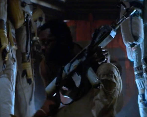

While watching the film yesterday I noticed in the sequence with Dallas in the air ducts, there is a shot when the flamethrower is side on. You can see the hole (bottom photo - 'centre').
What's also interesting is in the top picture there is no cut out with the gas knob yet in the film the unit appears practical.
Colin

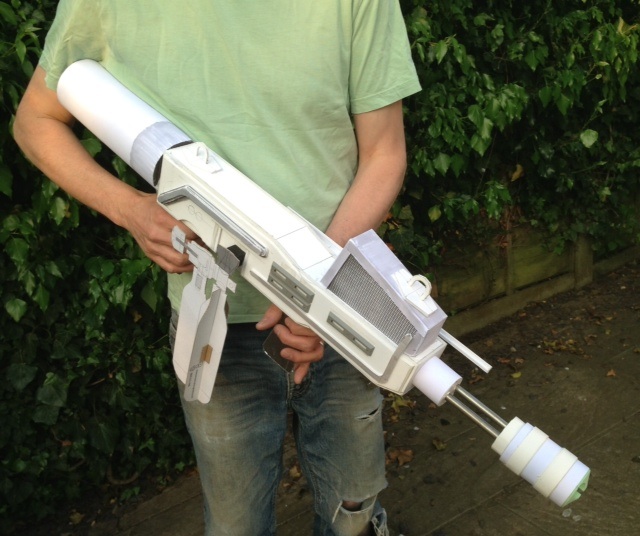

I managed to put a 2nd mockup together in the last few days, based on my new drawings. Using foam-core and card this time.
It definitely feels a better size. I've made the body longer and slightly taller, widened the grips, and enlarged the diameter of the rear tube slightly.
I spoke to Birdie and he gave me some useful information about the scuba tanks he bought (Thanks Birdie).
I can't decide if it's too wide now. It certainly looks quite wide in some shots, like when Dallas is firing downwards or when Ripley comes down the ladderway.
