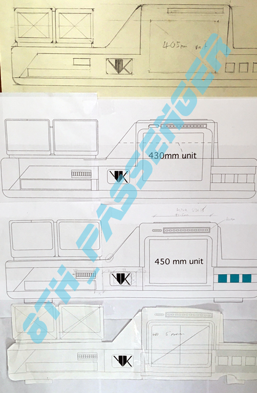

Over the past few months since finishing my Flamethrower project I've been working on plans for a Voight Kampff machine. In the past I have struggled to draw a version which has proportions I am happy with. As a result I have ended up with many unfinished revisions of the same drawing in CAD.
Here's an old one.
I've come up with widths between 405mm to 460mm.
My main priority with this is to try and replicate the proportions and look of the original prop built by Mike Fink.
I have recently started afresh using paper and pencil. Once I'm happy with the dimensions I will draw them up in CAD.
My starting points are:-
i) To have 3" and 5" monitors in a 4:3 aspect ratio.
ii) To use the dimensions of Tom Southwell's graphics as a guide.
iii) To stick close to the 430mm width of joberg's machine which I believe is a good size.
iv) To have 15mm square buttons (again from joberg).
I started by drawing a basic plan and elevations using the photo references from this site. The total width was 460mm, the same as the largest of my past attempts. I've called this 'Version One'.
I need to lose 30mm out of the width if possible. If I can get it down to 440mm I will be happy.

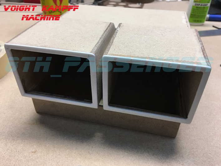

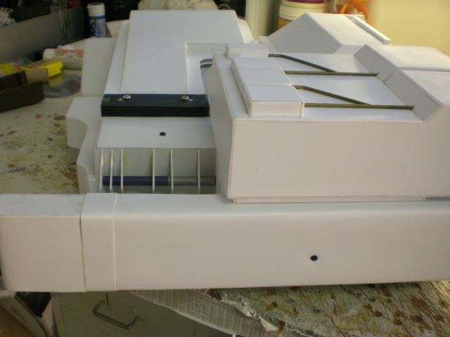

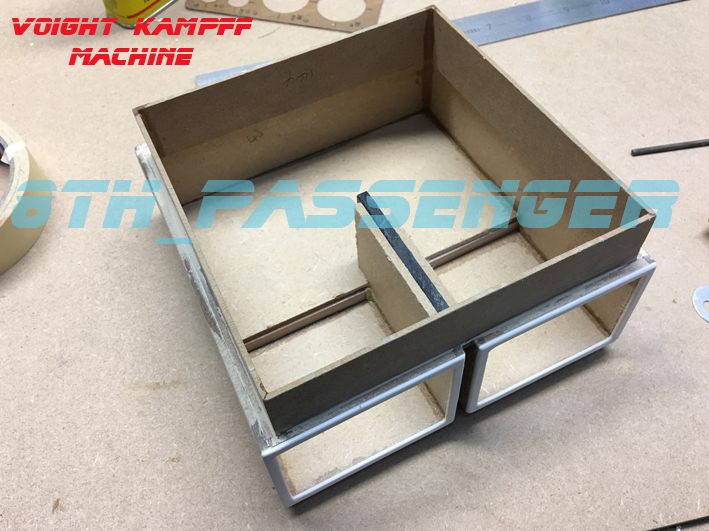

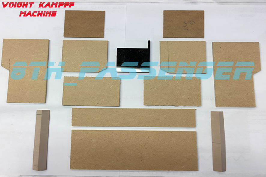

To help me evaluate the size of Version One I decided to build a mock up of the double monitor.
I cut the shapes needed to make the monitor.
Then assembled them.
I sealed the MDF, primed it and gave it a coat of satin black spray.
I wanted to test out how a 'back-sprayed' vac form screen would look if I went for static screens.
Here's the result (The left screen has white paper behind).
Looking at this mock up I realized my screen size wasn’t quit 4:3 and looking too sharp in the corners. The front internal edges needs to mirror the curved corners of the CRT screens within.
When I redrew the monitors I ended up with a screen size of approximately 2 7/8” on the diagonal. To see how this looked I modeled a digital one.
This decreased the overall width of the double monitor by 4mm and made it slightly taller.
I then noticed on my main drawing I’d drawn the buttons at 17mm square! So I had to redraw that area. These two revisions brought the overall width of the unit down from 460mm to 440mm.

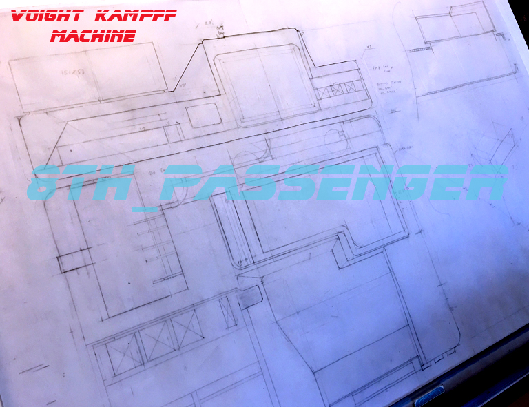

Version Two on the drawing board (reworked over my initial drawing).

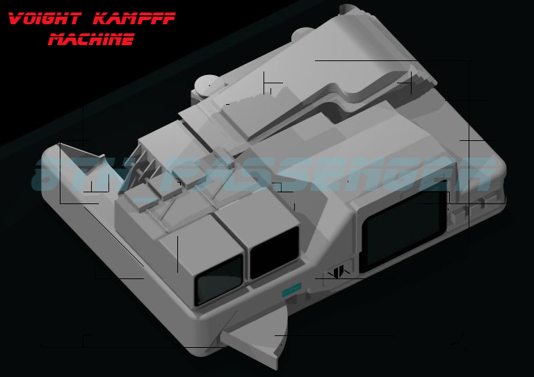

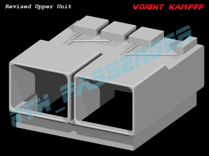

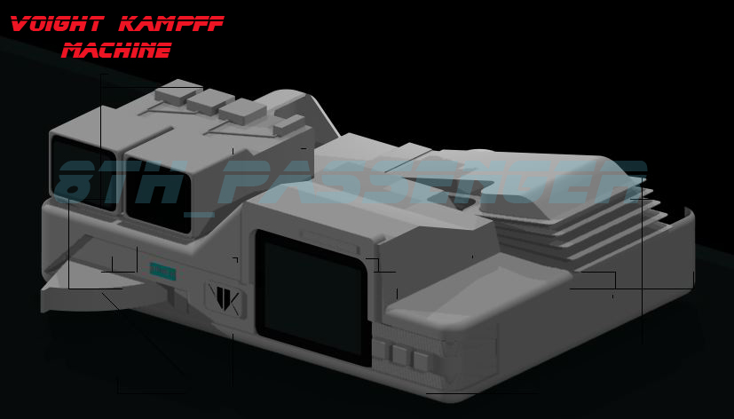

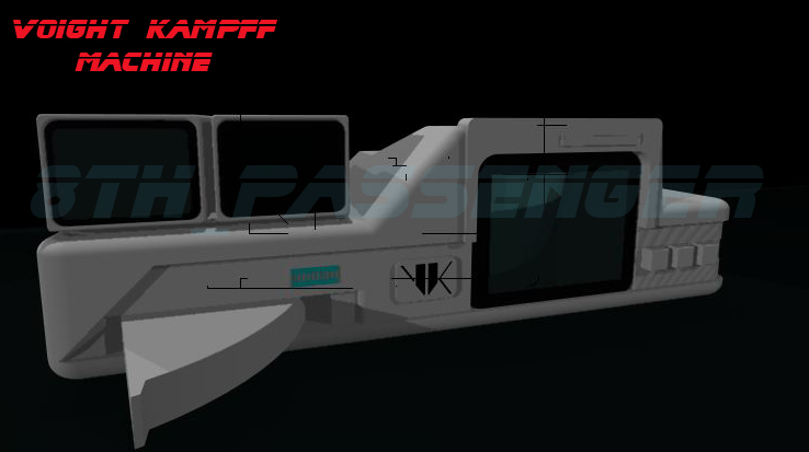

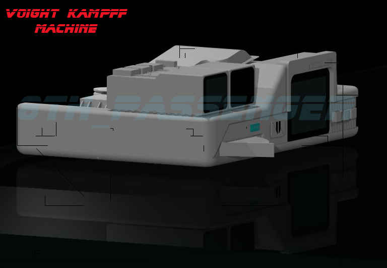

At this stage I decided to build a digital mock up of the whole machine so far. By doing this I would hopefully be able to see how things were looking proportionally and where I might lose even more width. That last 10mm.
Having only sketched out certain details at this point it was an opportunity to develop the size of the bellows, front drawer thing! (anybody know what that is?), graph bars, 5” monitor and the space for the arm assembly.
Just as a note I've not rounded off all the edges in these digital renders.
During the modeling I found I needed to reduce the width of the housing the top graphic sits on by 8mm. This meant 8mm had to come off the overall size of the 5" monitor to compensate. I took 4mm off the screen surround leaving the 5" diagonal portion untouched.
This now put the overall width at just over 430mm.
I continued with Version Two and saved a few renders to show you the overall size and feel.
So time now to start Version Three.
There are various things I've spotted already that I've not got quite right (in my eyes).
The loss of 8mm from the height of the 5" monitor will cause me problems when redrawing my front elevation. Also the sizes of the graph bars available today don't seem to match up with the ones on the original machine! I'll try and illustrate what I mean in my next post. Also I have a few thoughts on the look of the bellows.
For the time being it's back to the drawing board.

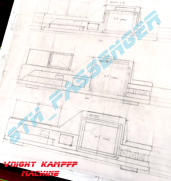

So I feel no closer to a final size.
I have decided to make a mock up of version three. I feel I need to see it in front of me to make a judgement.
What would an ideal width be? 400mm?

I will also try a new drawing with a 4" monitor. This makes the screen 90mm wide rather than 100. So 10% smaller! Scaled proportionally that would make the machine 387mm wide!

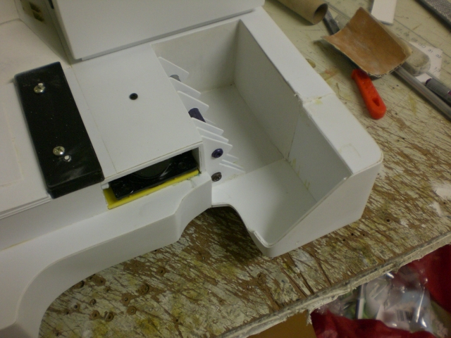

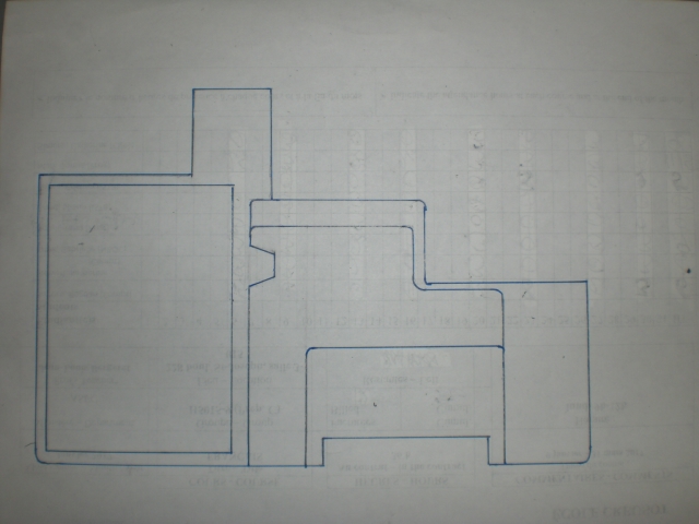

Here's the top from...the top view. So it's the prop facing the viewer normally.
Not a lot of "top side" on the right hand side of the machine, but enough side material coming from the "bottom frame"
Here's the left hand side: the piece affixed to the side is where the top abut...and you see the screw on the side.
Top near the trench and the bar attachment for the bellows...and the screw on top.
So, since the top is completely cut-out for the bellows, there's maybe 10cm from the edge of the face to the cut-out (hence the screw).
I think that's it. Colin, if you have factored in the size of the big screen, did you try (looking at the pics) to fit one small screen into it and see what's you're left with?[/img] |

Here's the 3D sketch of the top vac-form.
Today I've rescaled the front elevation three times.
The drawing at the top came in at 360mm.
It has a 3.7" diagonal screen based on the size of a Sony color TV available at the time.
Because of the screen size I had to reduced the three square buttons to 12mm x 12mm.
360mm too small I think.
The second unit down has the 90mm x 70mm screen which works out at a 4.5" diagonal screen. Again I utilized 12mm square buttons. This unit came in at 400mm.
The third unit down has a 4.5" diagonal but I kept the square buttons at 15mm this time. This unit came in at 415mm. To keep the 15mm square buttons I had to add more material to the overall monitor.
With the latter two units the size of the double monitors didn't decrease much from my versions 2 & 3. I guess that's something positive.
I have managed to draw the graph bars in all the units at the size they are availible today.
On the third unit the top Tom Southwell graphic stays at about 95mm long. Though its not quite like the dimensions I scaled from the photo here. Which work better on my 430mm unit.
Here's how far I have got with the 430mm mock up. Definitely good to see it in three dimensions. Looks totally different and different again in these photos!
Looking at mini TV from the early eighties doesn't help that much as non seem to match exactly. Like I said sony did a color flat screen at 3.7" on the diagonal and they also did a 5". Nothing in-between as far as I can tell.
I need to see how these changes in size affect the arm assembly and overall plan.
