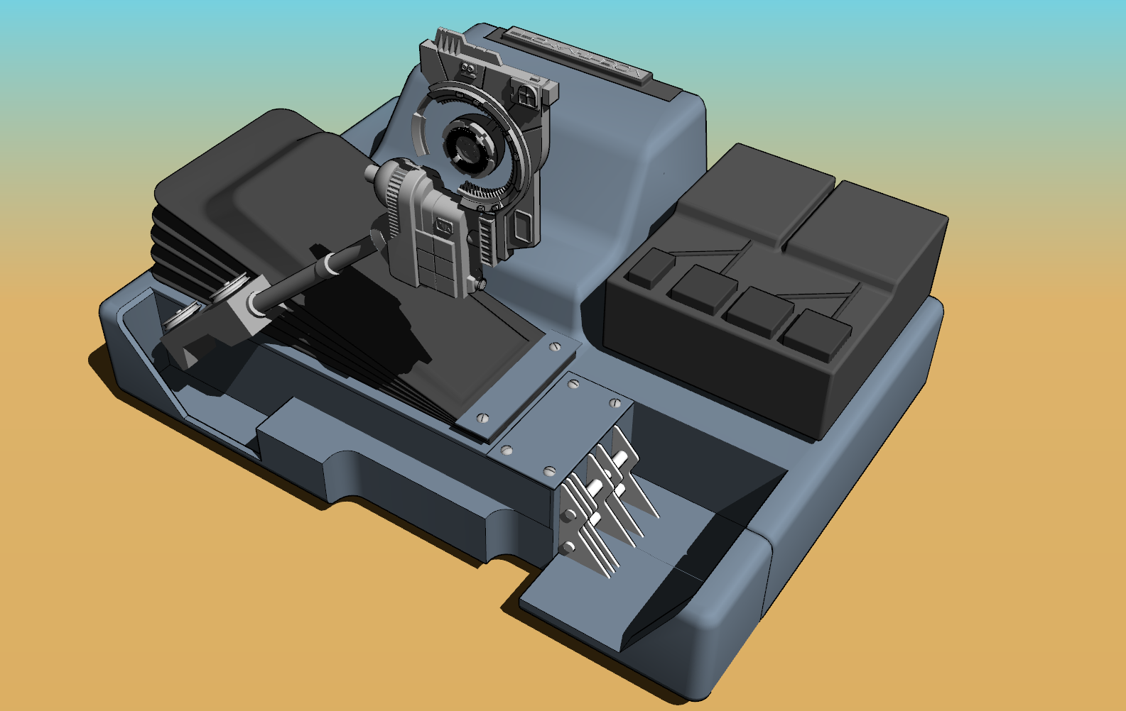

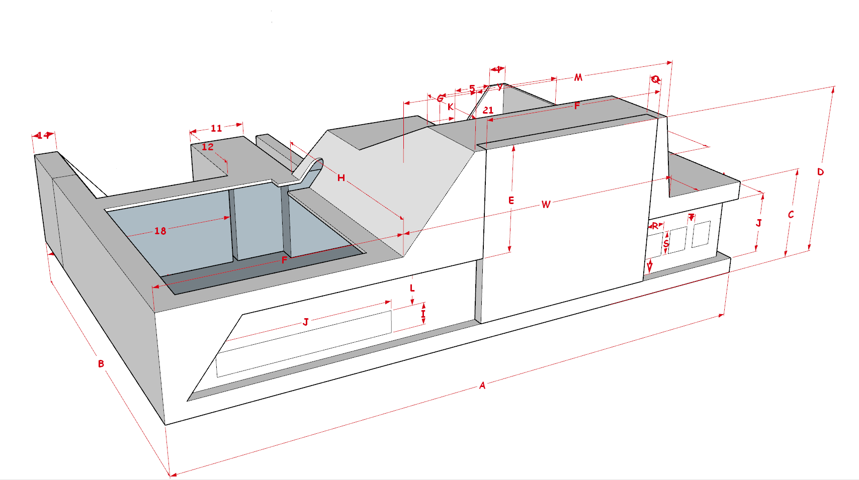

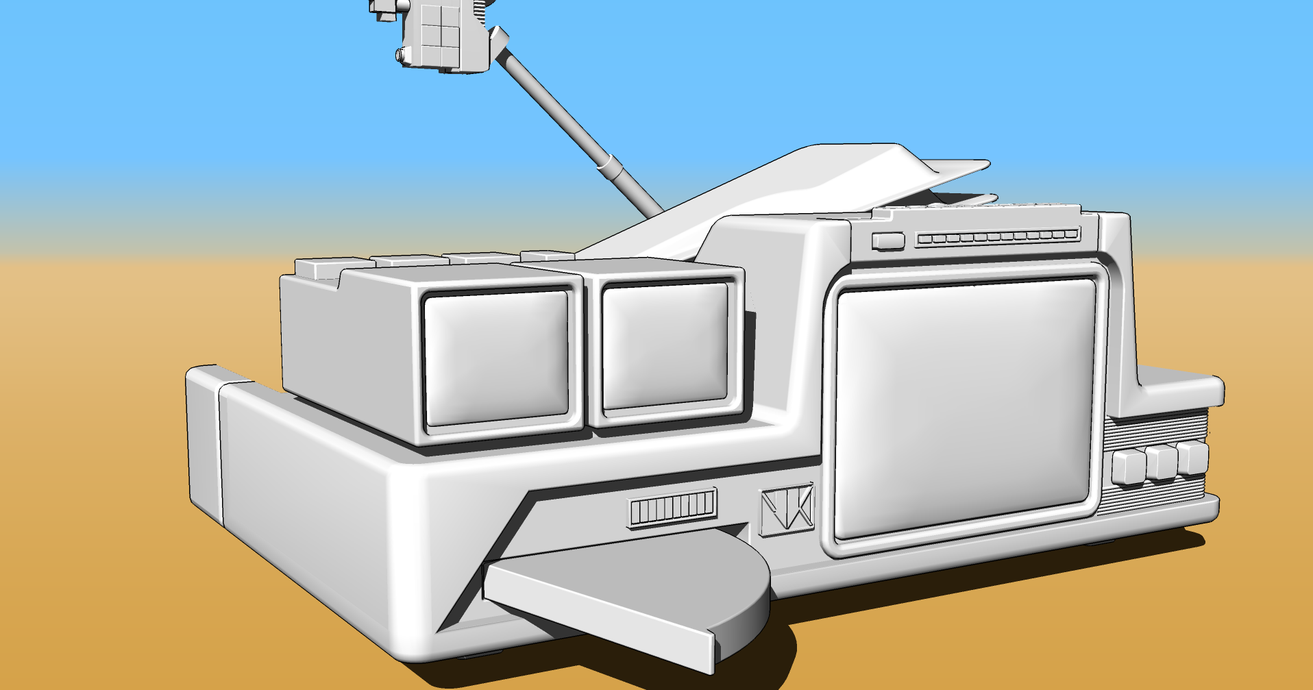

Hi to all, and thanks for allowing me to join this amazing forum.
I figured I might as well throw my hat into the Voight-Kampff replica ring, so here goes.

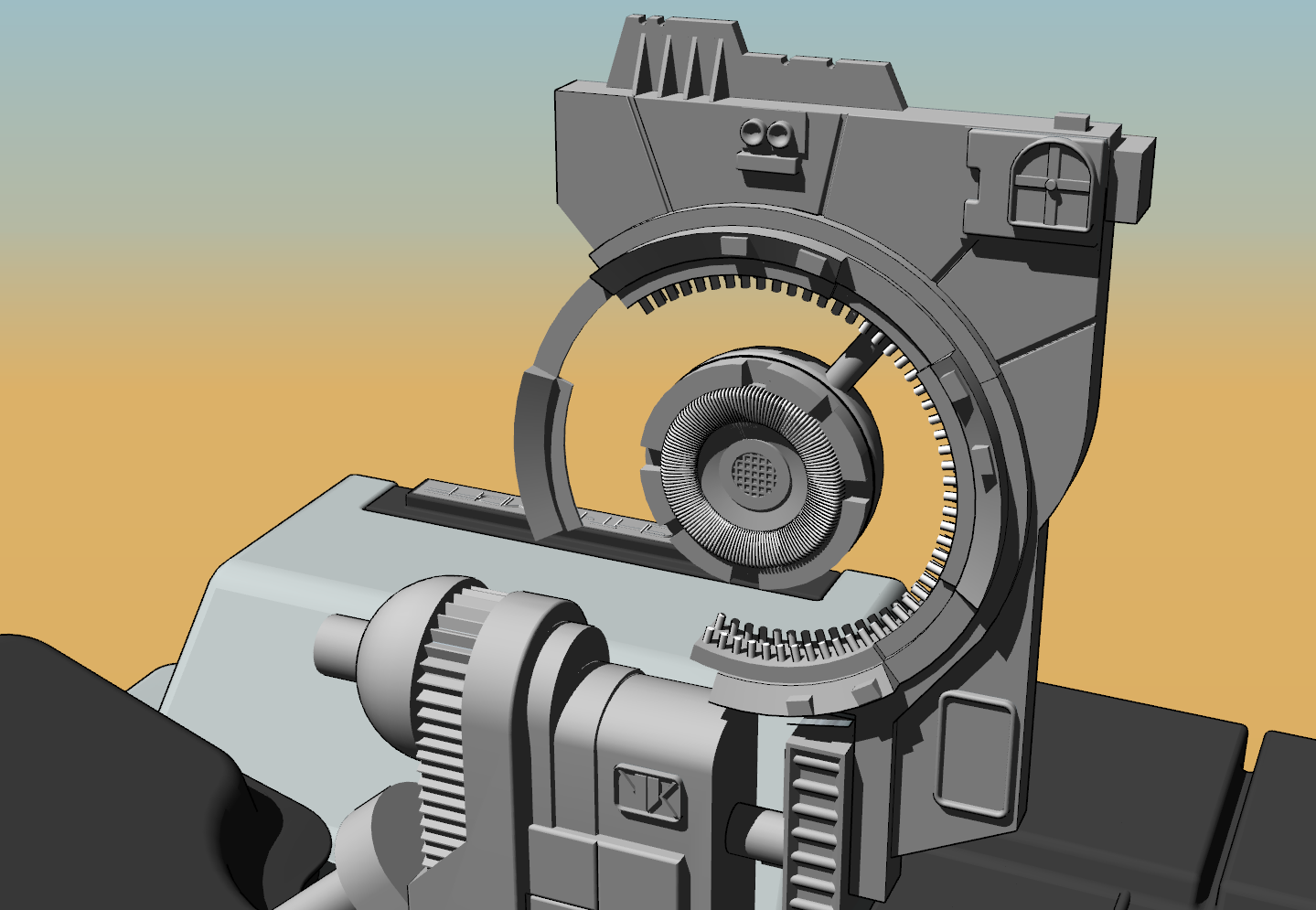

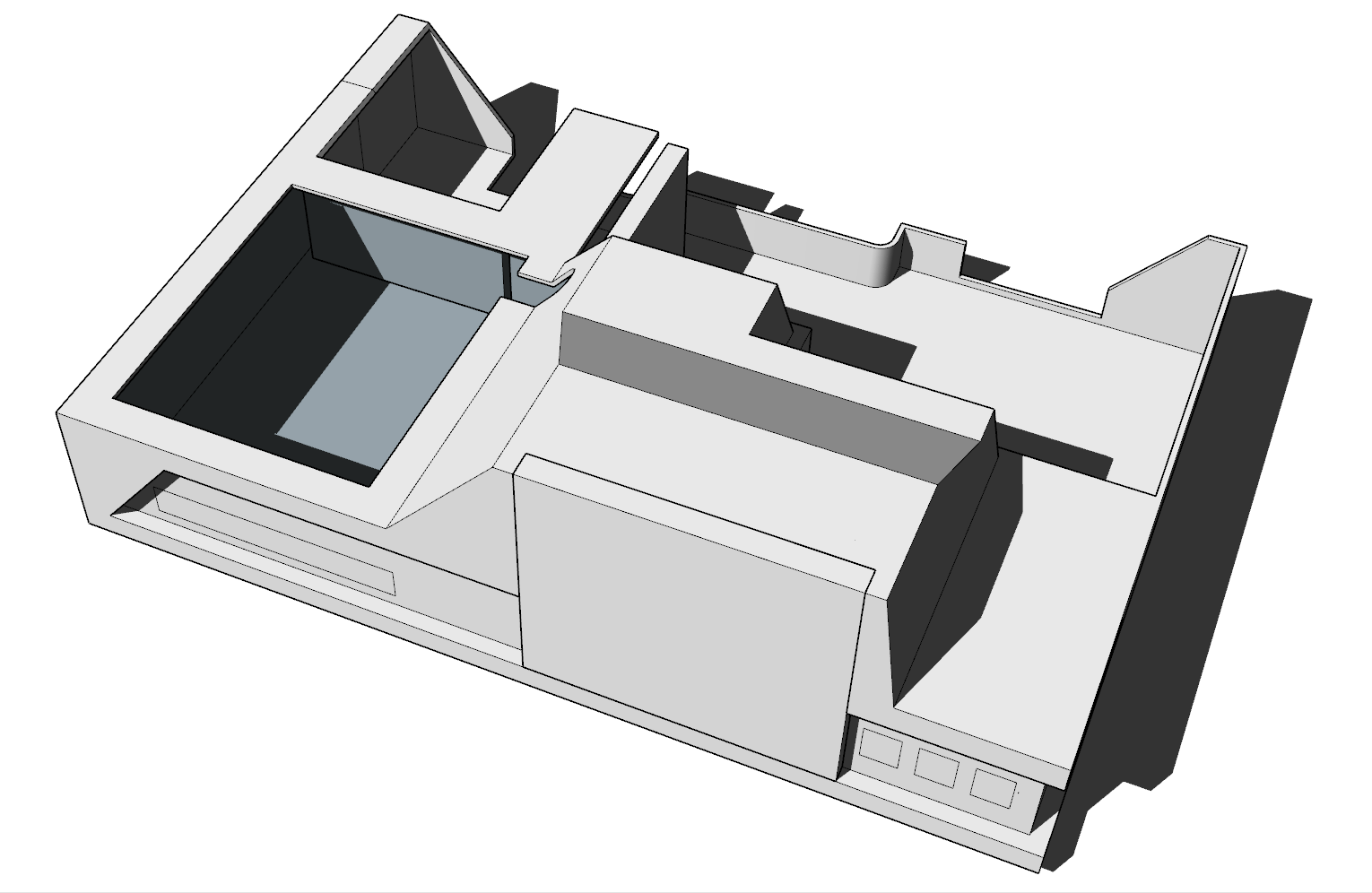

Mine is not a physical build, but a 3D model. It is a long way from being finished, but when it is I will make the model freely available for download for anybody that's interested. Feel free to do what you will with it. Maybe somebody would be interested in using it for a 3D printed model. I myself know nothing about 3D printing, but will gladly make any changes that might be necessary for that process. It could also be used as an aid for those aspiring to build a physical VK
So, some pics of what I've got so far (at least I hope you will see the pics, I've been having real problems with this but I think I've got it figured out) --

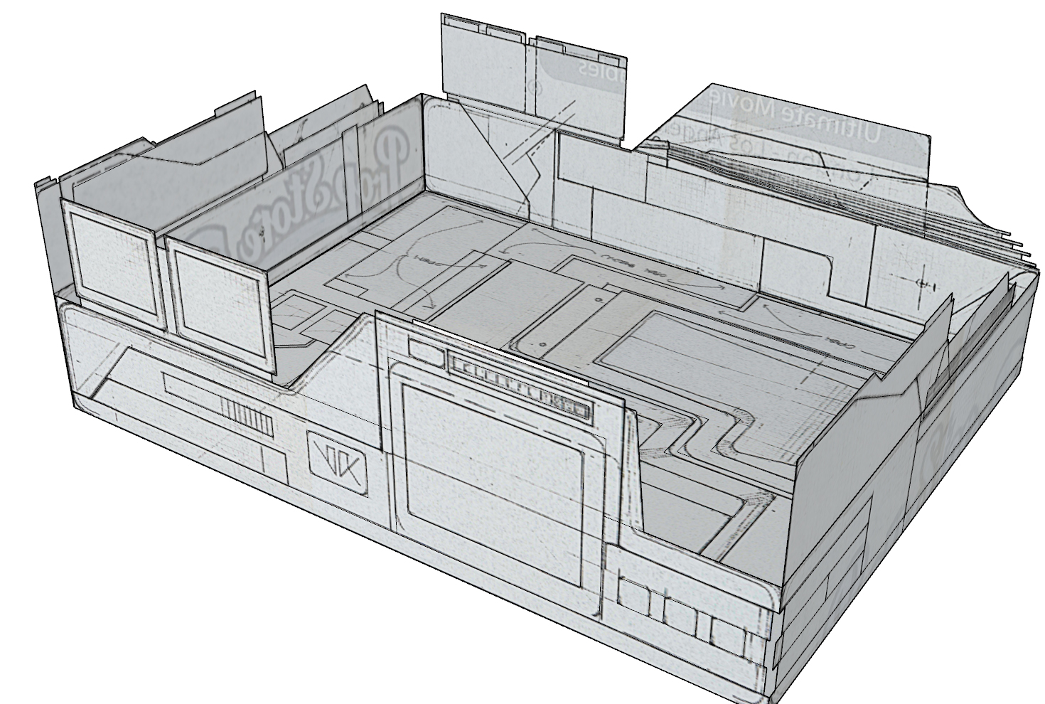

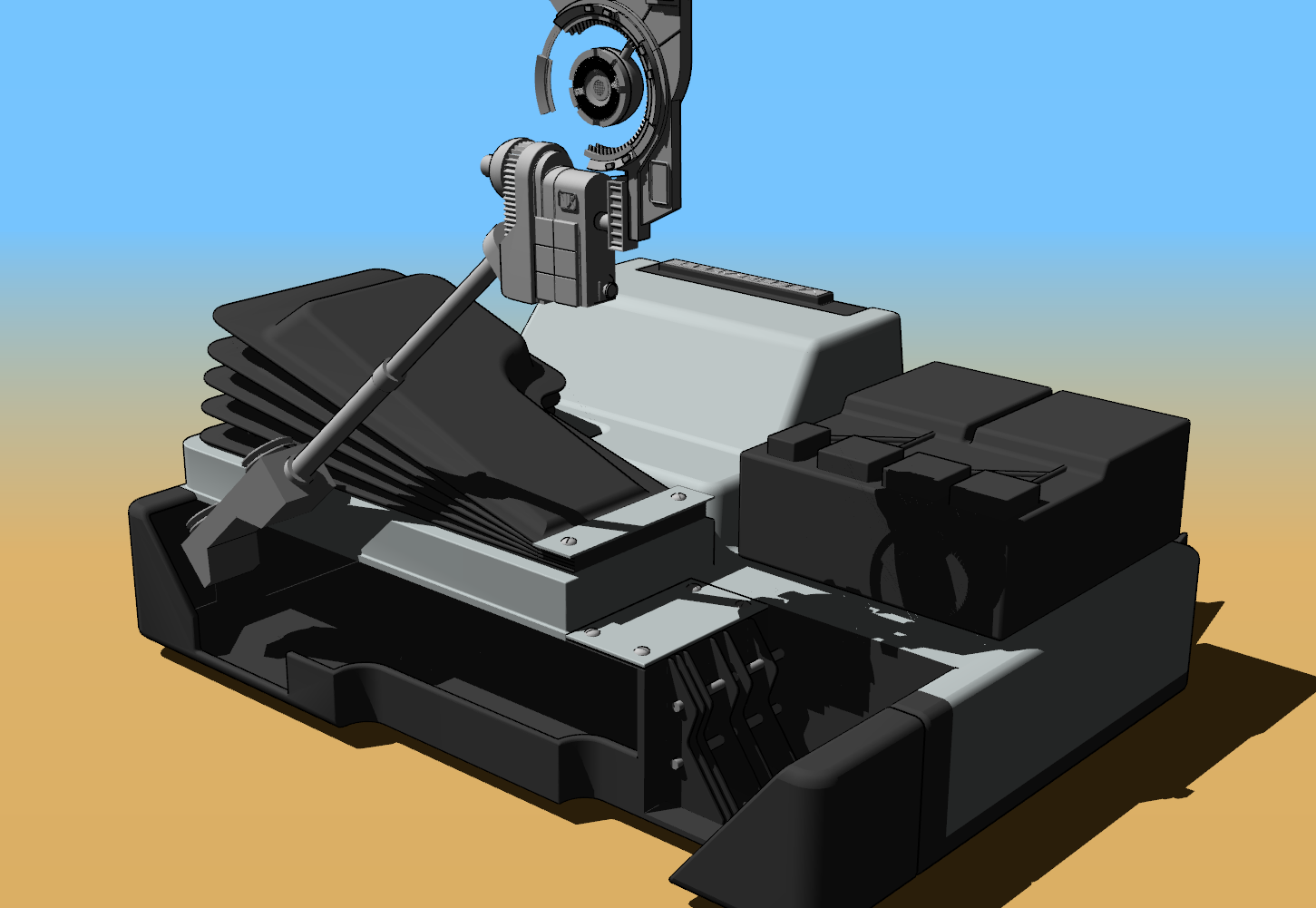

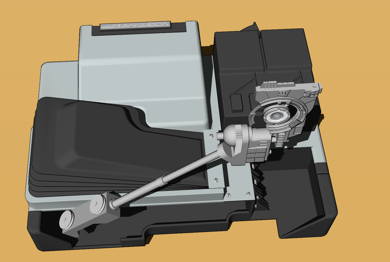

Here is what it looked like this morning. As you can see I've made some progress

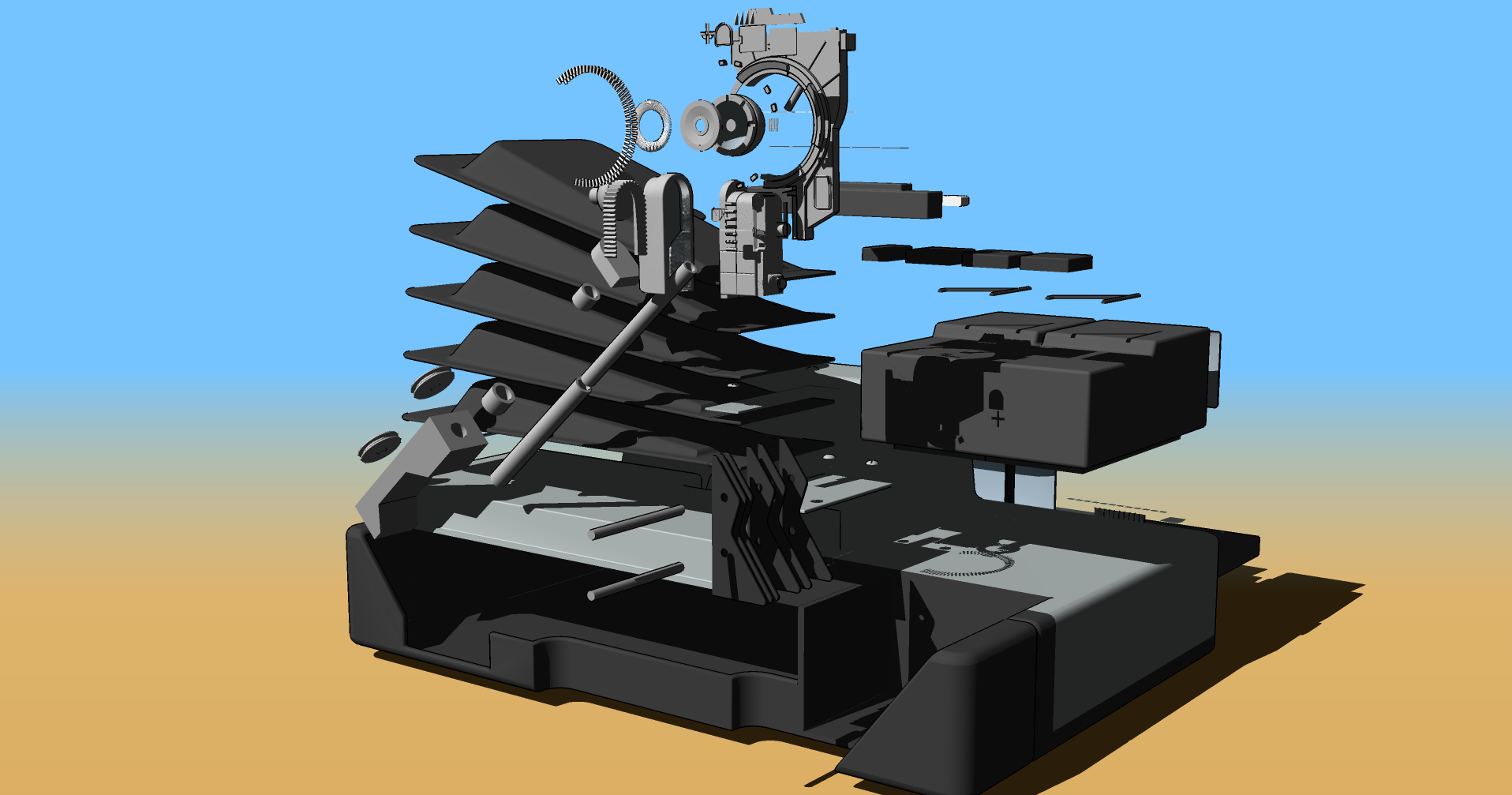

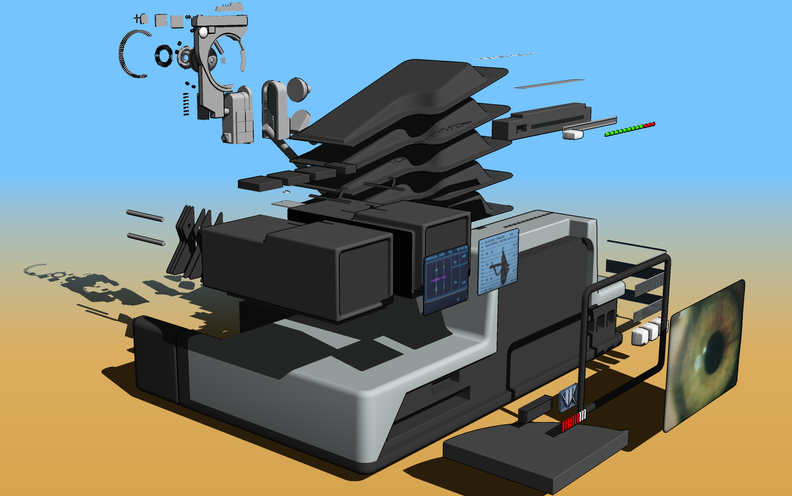

Some exploded views. Each part is modeled as a separate component. Components can be combined into a single component, as needed.
An X-ray shot. Not really useful, but sometimes interesting
Some monochrome shots. This is what I mainly use when working on the model. I just added some colors and projected some images onto the screens to help me visualize how it's going
Much work left to be done, obviously. Many things missing yet, and undoubtedly there are many things that I got wrong, and that's why I'm hoping to get some help and advice from all the knowledgeable people here. Any suggestions, comments, criticizms are welcome.
Think of it like building a Voight-Kampff by remote control!

PostPosted: Thu Nov 30, 2017 7:48 am    Post subject: Reply with quote

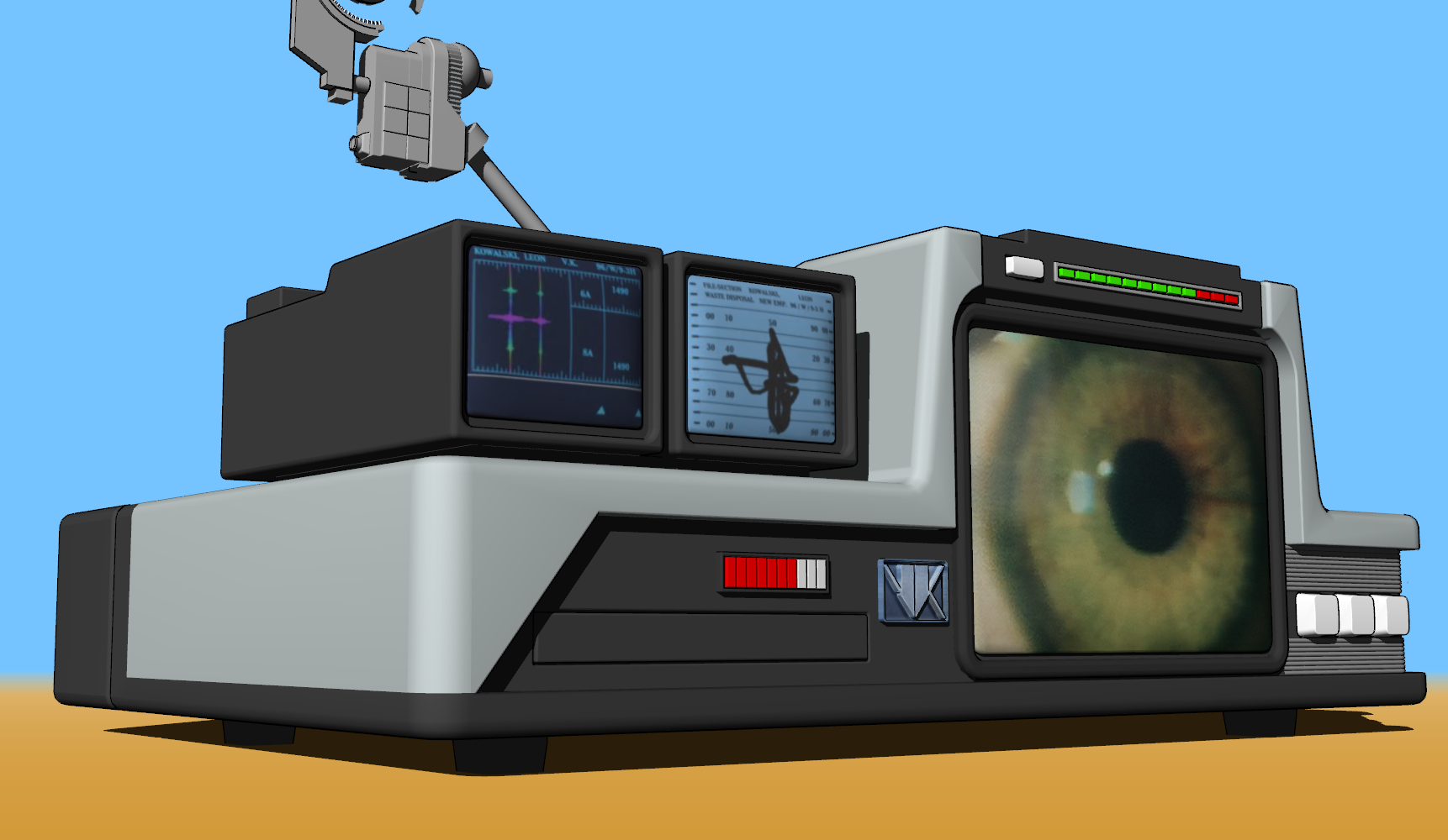

Steve, so far so good and yes, the original V.K. is the most popular because of the fact that it was the original prop built in 3 days by the prop team.
You seemed to have mix both (U.S/U.K) in your render: you've managed to squeeze the V.K. logo between the LED bar and the big screen (bottom left).
You've added the platform under the bellows (trying to visually mimic what these were doing on the original prop: i.e. rising above the big screen and its housing).
You've added an additional fin in the trench (only 5 in there + 5 small one at the bottom)...
As for the arm, the main aluminium part (the one with the 2 pulleys) is too short. Since the half of the rod has to slide inside it. you'll have to length it.
When the rod is half inside that arm, then the entire head/eye parts will be snug into the trench.

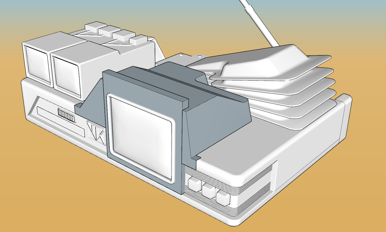

While I knew from reading the forum posts it was the most popular, I didn't realize just how popular it was. Nobody seems to be interested in the U.K. version at all. Well, I'm adaptable.

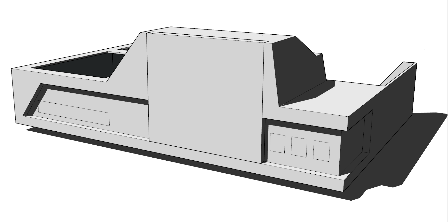

I removed the screen housing and inserted part of the shape that I had blocked out for the U.S. VK. And removed the platform under the bellows.
Then I blended it into the original model...
[/img]
Unfortunately, all the people who viewed my thread and summarily dismissed it probably won't look at it again to see that I have switched to the other version.
Thanks, this is the type of info I need. Deleted the logo, but I'm not sure what you are saying about the platform under the bellows. While I 'm sure it's not accurate (could not find any information about it, other that they did add a platform to make the bellows more visible behind the larger screen housing), as I said, I'm not sure what you saying there.
As for the fins, do you mean that for some reason they took away a fin in the U.K. version?
Yeah, I know that the arm is not accurate. I only did a quick job of it as a "placeholder", so the eyepiece wouldn't just be hanging in the air Laughing
Anyhow, I'll wait and see if switching to the "popular" version generates any interest in this project.
Thanks again for the input, very much appreciated.

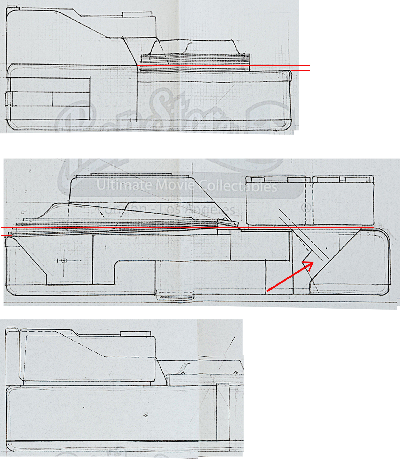

Sorry Hellnback, 6 fins in the trench + 6 small ones on the floor of the trench...see Colin's V.K. project.
The big screen has to be smaller in height, since you removed the platform under the bellows.
The top of the big screen should only protrude from the housing by 3 mm and topped by the Voight-Kampff plate (2 mm).

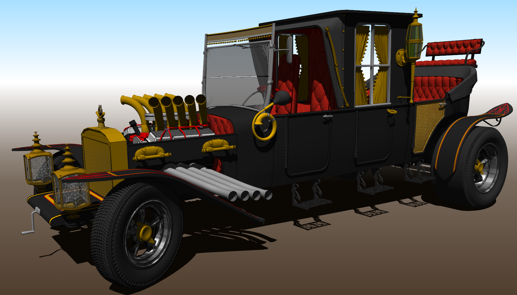

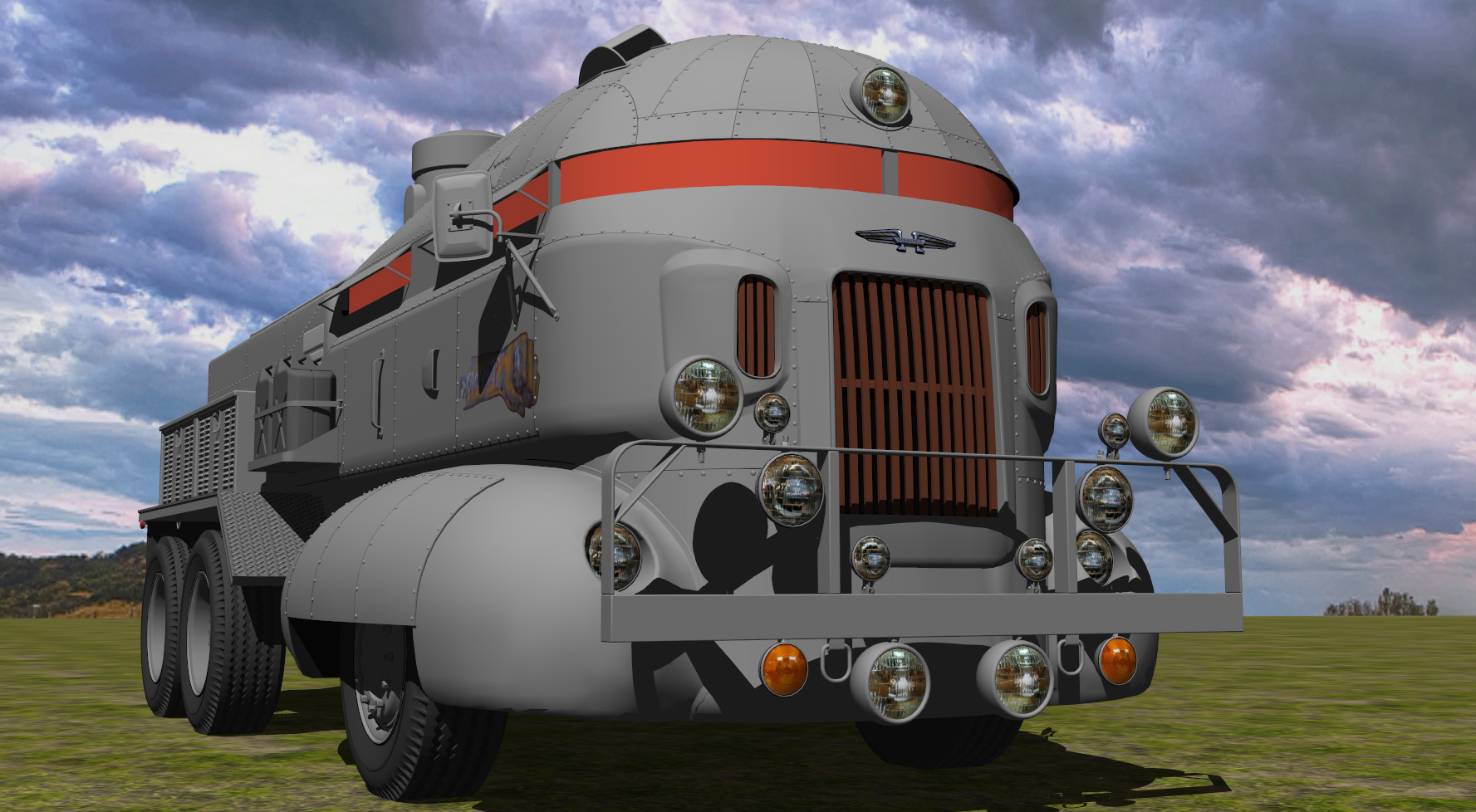

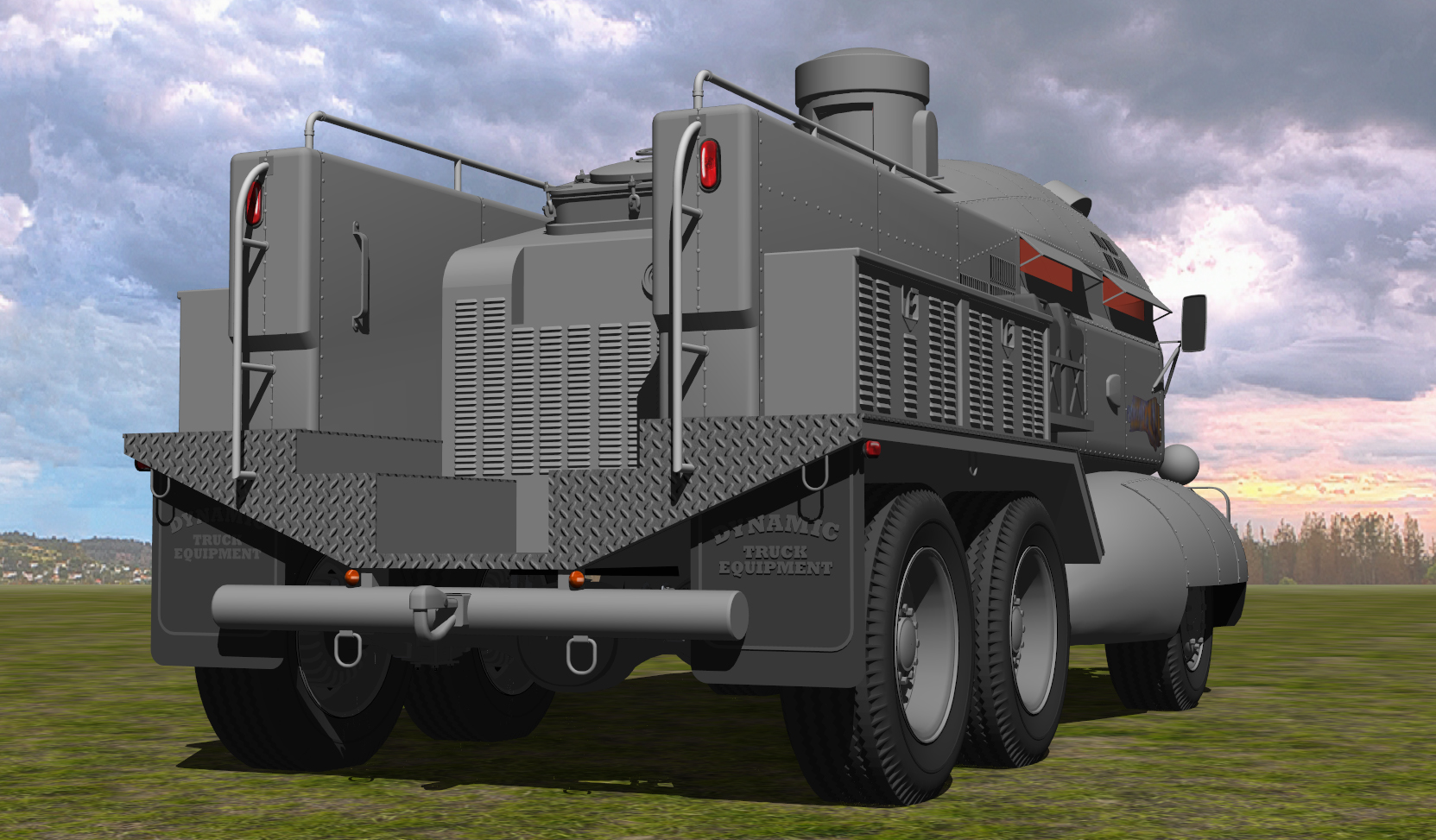

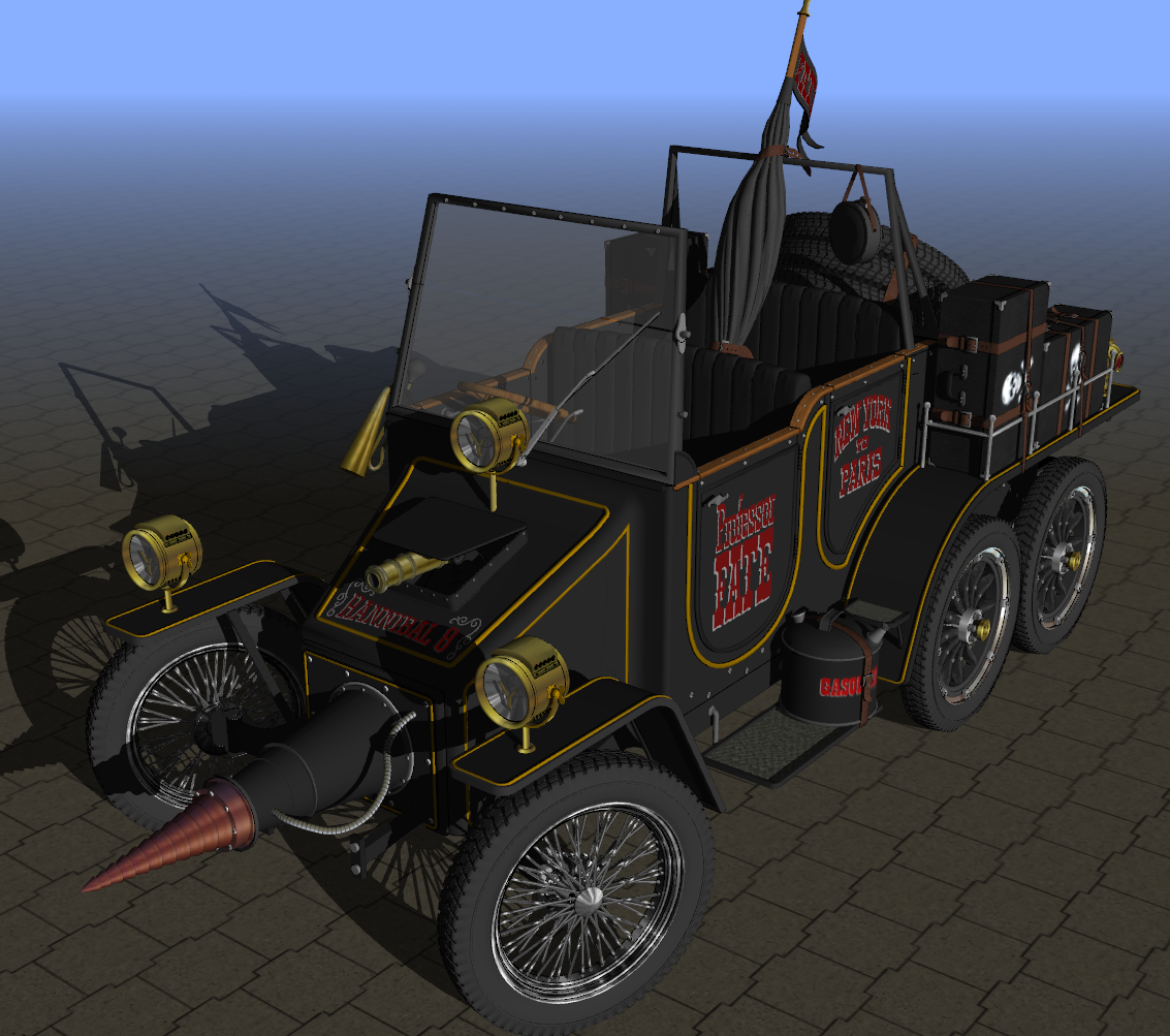

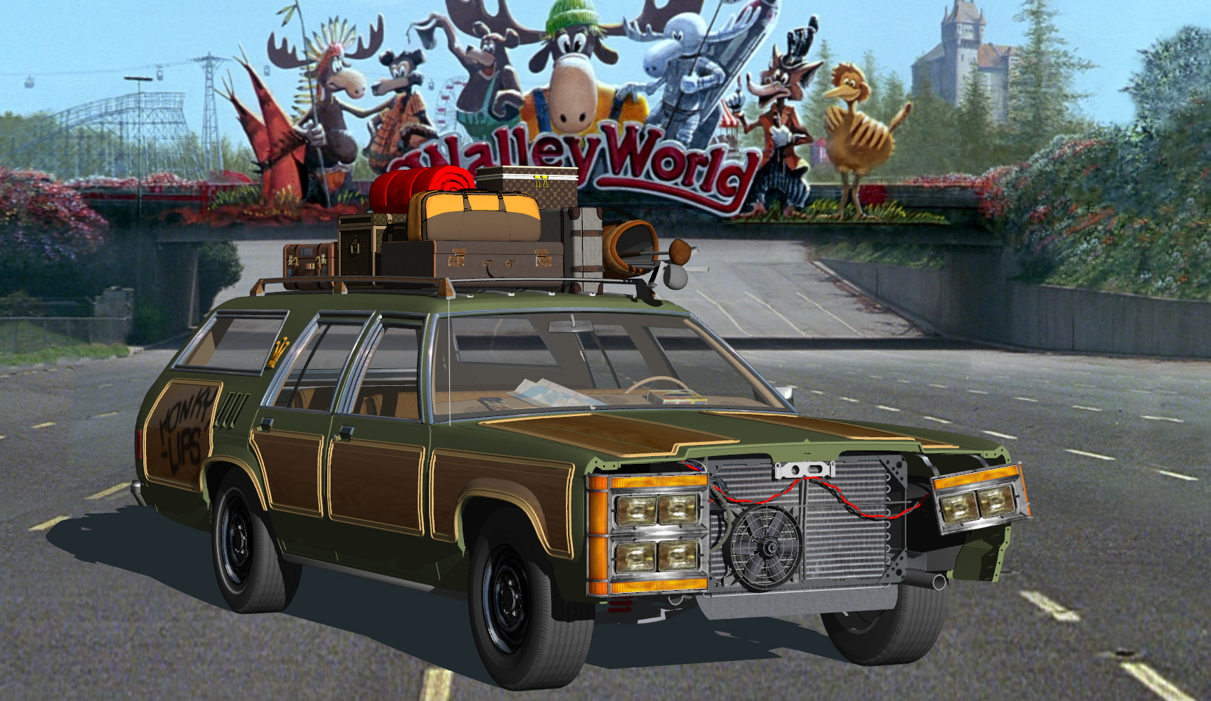

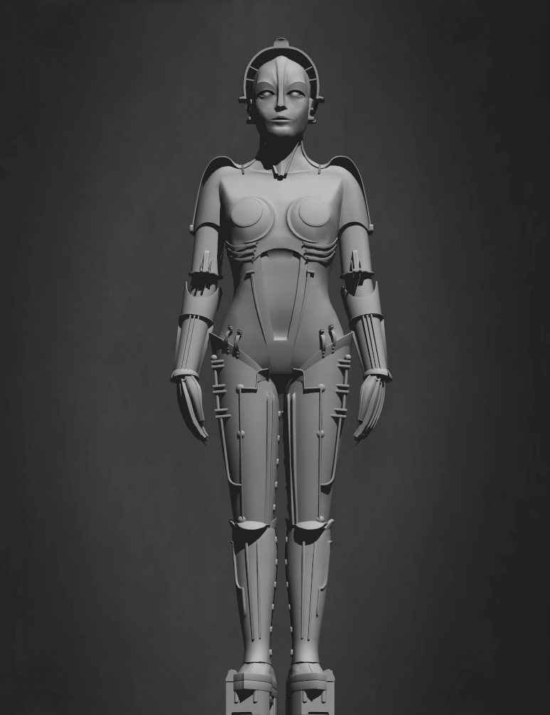

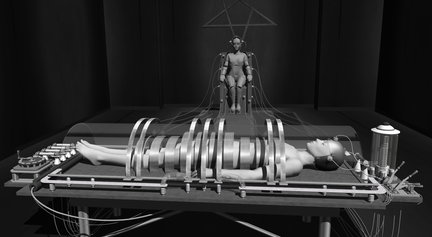

Before I throw in the towel, I'd like to take this opportunity to show you a few of my other models based on various movies and TV, to maybe give you an idea of what I hope to achieve with the Voight-Kampff. Some of them are not really finished, but anyhow......

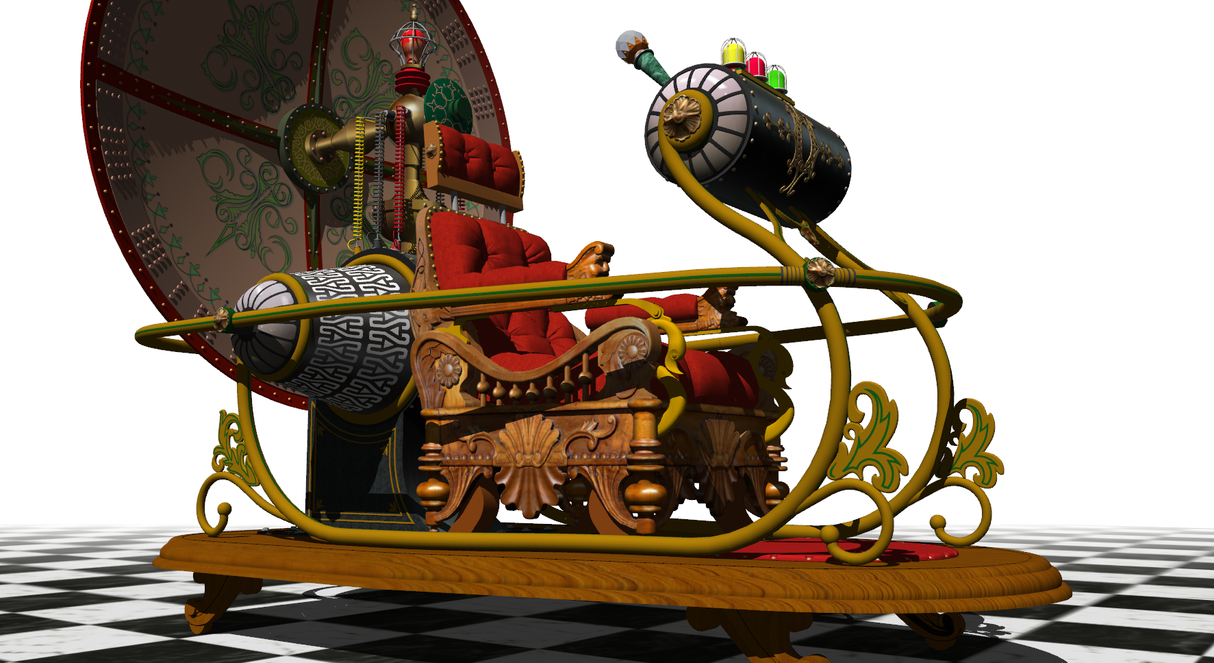

The time machine, from George Pal's "The Time Machine" 1960

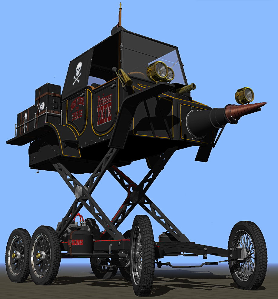

Professor Fate's Hannibal-8 from "The Great Race" 1964
The False Maria robot from Fritz Lang's 1927 silent masterpiece "Metropolis"
The Herkimer Battle Jitney from "Mystery Men" 1999

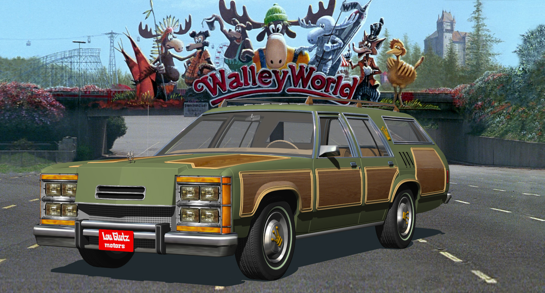

The Wagon Queen Family Truckster from "National Lampoon's Vacation" 1983
Before ....
and after
and The Munster Coach from the TV Series "The Munsters" 1964-1966
As I said, I have no idea why my project is being shunned while others receive enthusiastic support. I was hoping for your input to ensure that this model would become as accurate and complete as possible, but without that input there is no need for me to continue here.
For those that have provided input, my heartfelt thanks and appreciation.

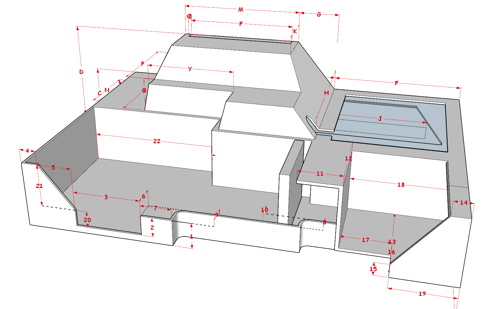

Been spending a lot of time today going over all of the VK threads here and at RPF, and my head is swimming from trying to make sense of all the discussions about every aspect of the machine. So much info, so many differing opinions, and it all changes from thread to thread!
To make it simpler I have captured each page of each thread as a scrolling window, as both a png and PDF image, so I could study them without having to be online.
I have taken my model back to a basic shape for purposes of getting the various shapes and dimensions as accurate as possible. When I'm satisfied that I've accomplished that then all the rounding and smoothing and whatnot will take place, but, just like building a house, it has to have a good foundatiion or everything else is pointless.
I have no doubt that there are things wrong here, but I'm sure that with input from those that are much more VK-smart than I it can be made right. That mysterious and elusive trench will have to come together from a consensus, and I will have to resign myself that it will never be correct. But one can only work with the information available.
I will be asking for opinions on the various dimensions, and, again, given the lack of proper diagrams or blueprints, those will have to be determined by consensus. I don't hope to get all the dimensions pictured here, of course, and at this point I will not be asking for any, not until I have sifted through the forum threads and mined all the information I can.
For now, please feel free to offer suggestions on what needs changing as far as the overall shape of the machine is concerned. The area under the bellows and in the trench is still a grey area for me, so any help you can provide would be much appreciated.

Hi Hellnbak,
Here's how I'm approaching my Voight Kampff project.
I decided to scrap all my previous attempts and use the blueprints Propstore posted.
I'm taking it on good faith that they are genuine and therefore the proportions are reasonably correct.
I have drawn many incarnations of this machine at various sizes but I always keep coming back to one size.
430mm wide.
The reason the machine ends up this wide is to do with the size of the razor foil. The foil determines the size of the head assembly, which then affects the rest of the machine.
I took the clearest/flattest images Propstore posted and lined them up as plan and elevations in photoshop. I then enlarged them all so the front elevation was 430mm wide.
I then imported this image into my CAD software and stated drawing over the top of it. Making adjustments and educated guesses as I went along.
To draw the head and arm assembly I scaled up frame grabs of the head and the photo of the rear of the machine Propstore posted with the blueprints.
All the time cross referencing these with with the other photos that are on this site.
I will also say joberg's build photos have been incredibly helpful.
Whether you choose to do the UK of US version the base of the machine is the same.
Most of the measurements you require are in those blueprints. But you have to decide what size you believe the machine to be.
By what you have already drawn, you have a passion for the project. I think a fully rendered CG model will be a good addition to this forum.

Colin,
I had studied those prints from PropShop, and to be perfectly honest I didn't have a lot of faith in them. To me they appear to be more or less just sketches, and don't seem to have been drawn in relation to one other, just sketches for visual reference or something.
But I took your advice and decided to see how they worked out.
And things didn't line up very well at all. I didn't expect the lines to actually intersect, but some of them were way off.
I have a question. It seems to show the back half of the right hand side to be much lower. I've never seen this in any of the models, and can't really figure out why they would even do this. I have scoured the reference photos of the original prop, but none of them really show the right hand side well enough to tell anything. As far as I can tell, the only purpose for this is to allow the bellows to angle down, but why they would need to do that is beyond me. Also, another reason I don't have a lot of faith in these drawings is that it seems to show that they were planning, or at least considering, to have the arm pivot from the other side of the trench.
I could be wrong, I frequently am, but I think they might be earlier ideas, and they were changed as the actual machine was built. Which in my mind puts their value as reference photos in question.
This is probably just an old fart being difficult, but I would value your feelings on these things.
Steve

Hellnback,
I know where you are coming from.
I have those doubts too.
But I think these plans are a great starting point.
I think these drawings are the closest they got to drawing blueprints.
They took Syd Mead's sketches, broke it down into the elements they needed and started mocking it up.

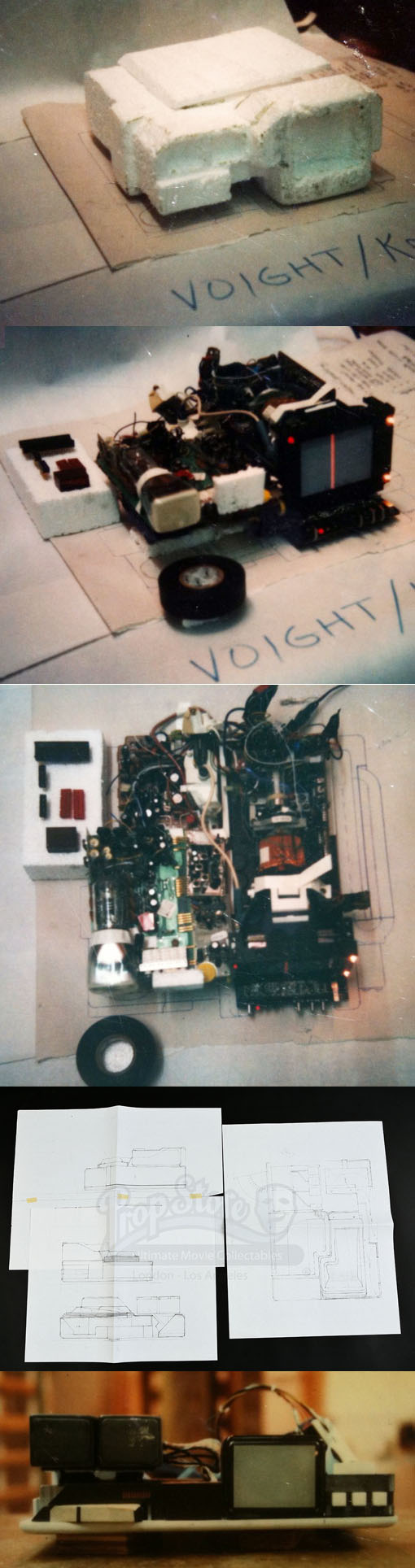

When they decided what monitors etc they were going to use someone produced this drawing as a guide.
From the pictures I have here's a very rough evolution!
I don't think those lines on the right indicate the arm was going to pivot from that side. They could be the angle of the head resting in the trench. Also on the left there is clearly what could be a pivot point for the arm.
The back of the machine where the bellows lie is lower than the upper cover. The bellows in my opinion do angle down as in the blueprints.
Here's some shots by Mark Stetson. You can see the differences in heights.
