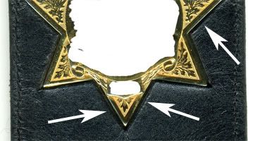

speaking about the badge, does anyone (particularly folks that own spinner44's wallet set) know how these badges are attatched to the wallet? My wallet just has a blank leather board with the intention of manualy cutting the badge shape out.
I think most badge holes are usually custom die-cut so they have nice sharp edges and fit the badge perfectly.
I would trace the outline of the badge and then cut out the backing with an xacto knife, then use 3M automotive tape to hold it. I've worked with that stuff in the past and once it makes the bond, it's very difficult for it to come off, even after several years.

It looks like very thick leather, which I imagine shouldn't be too difficult to cut if I keep scoring slowely. I'll have to cut it slightly smaller than the badge so it fits snug.
Thats a good idea with the tape svander, though I might try and put the badge on some kind of backing like this
the thick leather is very tight to the wallet so theres no chance of it slipping out the side or anything.
gonna try and get the badge casted at the weekend
That is how the badge I got from bbabich last year(?) was held in place, with a leather backer that the pin goes through.
Good luck with your casting attempt and take lots of pictures!

On our issued police badges, the badge maker showed me how they attach the badges to the leather:
1. Rough up the leather and badge surfaces to provide "tooth"
2. Use Devcon fast set epoxy (they are adamant about this brand)
3. Apply thin layer to badge and leather attachment areas but NO NOT JOIN
4. When first layer has dried, add second coat of epoxy and attach, use light pressure/weight until glue has set
Now, this is intended for badges that are carried daily and used. You may not need to do step 3 for a display piece. I carry my pocket badge at all times, and I've never had a separation.
On my very short run (my metal caster got ill and retired before I could get more badges cast) metal badge project, I used this technique and the badge sits flat and solidly in the wallet cutout.
I would avoid using anything that adds thickness to the badge such as foam tape, etc. The epoxy lays pretty thin, even in two layers. I woud NOT undercut the badge recess as it will cause the rest of the leather to deform due to the badge pushing against all sides. On real badge cases, specifically die cut for badges, there is a small gap (1/32 - 1/16") all around. They dye the cut edge black so it does not stand out
