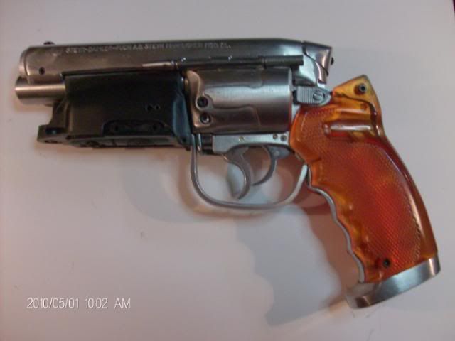

Ok well ,Rich provided the photos and I've done the mod's on the gun, so here it is nearly finished apart from the detailed weathering , I done some but not finished yet !
Right Profile
Better with flash
Left Profile
Better with flash
More photos to follow once the weathering is done ! |

Nice job. I would like to know, however, is it a photographic anomaly, or is the lettering on the receiver very shallow and undefined, especially in pictures 2 & 4? |

The lettering is identical to the deluxe unpainted blaster as shown, as is seen in photos five and six , it's just down to the lighting and that always is subjective -the flash tends to burn them out due to reflected light and no flash means it's to dark to see , as you'll see in photo five an six , because of the angle of view the lettering is much more visible. |
