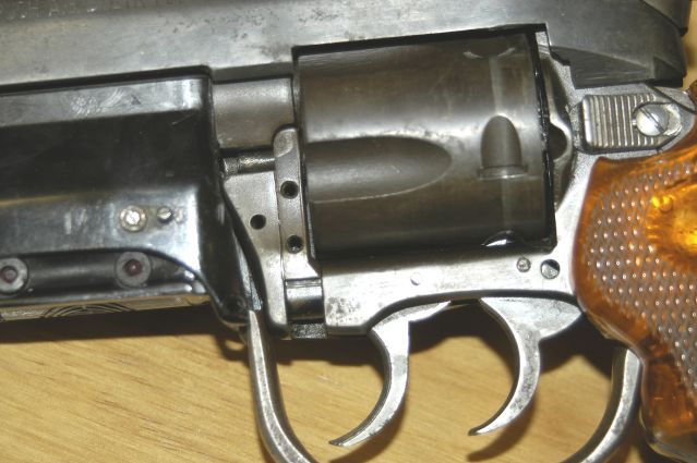

From that picture the hole in the cover looks larger that the hole in the frame and I can see NO threads cut into it from the bottom.
The second started hole might have happened when he was drilling the side cover and hit the arm.
That is a interesting picture one I did not get in any of the sets I have.
Do you have any more unseen pictures your willing to share?
Rich

Well as I have build one with that screw it only adds a couple of seconds to spin it off and then pop out the cylinder and then snap it closed and spin it back in and tighten.
It is as easy as loading a few rounds by hand unless your using speed loaders and on this prop a speed loader would not fit pass the grip anyway.
So hand loading was the only way.
Rich

I will check and see on the photo. If you notice the 4-40 hole in the receiver has a wall thickness of about .075 no threads. This is clearly a error in construction along with the drill start from the lower hole. The Hero has several mistakes like that due to a rushed construction that happens all the time in the film business.
racprops
Joined: 30 Oct 2006
Posts: 2450
Location: Phoenix AZ
PostPosted: Tue Jul 17, 2012 7:40 pm    Post subject: Reply with quote
There should be no threads in the frame...the screw goes though both the side cover and the frame and threads into the same 4/40 threaded swing arm hole the top screw that holds the side cover.
I think I see what your misunderstood how this is being done, the screw comes in though the right side cover and then the frame and then screws into the arm from the right side.
That then pulls the arm tight to the frame from the right side cover.
So you have to make sure the left side cover screw is short enough to allow the screw from the right side cover to also use the same hole, which I did on my shooting models.
And tell me about rush work...
Check out my web site www.racprops.com
Rich

Well I was working at The Hand Prop Room and Harvey our gun smith was changing recoil springs to lighter springs and putting in restricters to get auto loading and automatic weapons to cycle the bolts and rounds, so yes I kind of do know what is done.
The problem is in cutting off the cartridge injector of the Bulldog you lose the cone front lock that engages the frame aliening and holding the cylinder in place.
One builder made a new locking ring and machined his Bulldog to reinvent the front lock.
We believe that this side screw lock is what was done on the film and it seems to work. Other wise why drill a hole there in the frame...I never needed one for my dummy model build.
It only can be there to use this locking system. And it matches up with the large flat screw on the right side.
And the replacement of the screw with the weaver knob makes sense as they unloaded it after all was done and perhaps lost the screw, other wise what take a screw off to replace it with a dumb knob??
But lose the screw and you look for something to fill that hole.
Yes it takes a couple of seconds to use, but not all that much.
And it does make for a very improved safe gun.
One last thought, it also make reloading the gun a secret...not just anyone can pop it open and reload it.
You have to know how.
Rich
