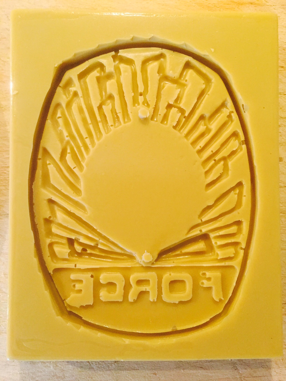

Done the first high temperature silicone mold of the mock up... As you can see: Total disaster!
I've totally underestimated the lower viscosity of the hi temp silicone contra the details on the badge... Result: MILLIONS of air bubbles...
Going to do some more research and get some more silicone....

When I was pouring the grips for my derringer skinjob advised me to dust my mould with corn flour and then bang it off so only a thin coat remains.
This will then pull the resin into all the fine details by capillary action.
This may work in a similar way if you dust the badge hopefully it will pull the silicone into the details.

Thanks! I think I'll try that.... Couldn't possible go worse than the first mold  _________________ Monsieur, azonnal kövessen engem bitte |
Posted: Sun Sep 13, 2015 5:49 pm Post subject: |
...and baby powder will do the trick also. Put it in, shake it off and pour the resin  |

You might consider trying another type of silicon. A friend suggested Smooth-On® brand, and another company, Eager Plastics (here in the States) makes a similar product. Neither requires "cooking" and take only a few hours to firm up.
I watched a friend pour some molds recently (this time without a vacuum pump). He simply drizzled the blue goo into the small nooks and crannies slowly building up a layer, and he used a small brush to insure that the goo got into all the details. Once that settled after a few minutes, he added the rest until he filled the box. (He had used LEGOs to build a box to the size and shape he needed). It takes a while to set up, but it gives the remaining bubbles time to rise to the surface.
He uses mold release or sometimes Pam to coat the object, if needed, brushing on a thin layer.

I think it's ok.... very easy to work with.... I think my problem is primarily the technique....
Mold number two came out just as bad and I'm out of silicone... I dusted the the mockup with baby powder and started coating the mockup with a thin layer of silicone that I pressed down in the crevices lightly with a brushed.... Had my hopes up, but it didn't work
Found a company in the UK that carries a Smooth-On product... Trying to convince them to ship to Denmark... Fingers crossed!
I'll probably end up getting a vacuum chamber.... _________________ Monsieur, azonnal kövessen engem bitte |

If you have a little extra silicone, might you try molding up something with less detail? It seems to me making a mold is an art. I'm just wondering if molding up a simple box or dome might build your skills and confidence. The FORCE badge just has so many places for bubble to hide.
The suggestions put forth here have helped me too as I learned the dark art of mold making: The baby powder, pouring from high up to get a very thin stream, gently poking around through the rubber to (hopefully) release air bubbles.
