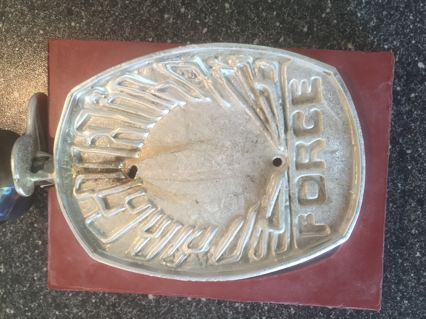

Good news! With the absolute last of the old silicone I was able to do this very thin partial mold... It proves that it can be done... And more important, it shows that I can do it.... Optimism returned Very Happy Very Happy Very Happy
I simply painted the silicone on with a brush in a very thin layer... Gave it time for the bubbles to rise to the surface, then poured in the rest very slowly.... This is the method I'll use when the new silicone arrives...

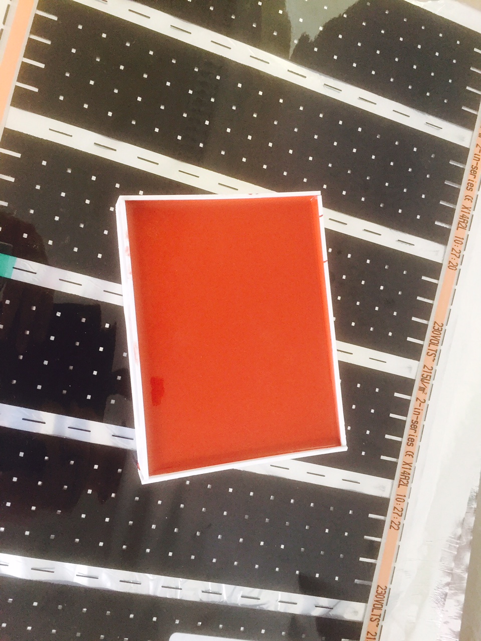

More good news! I got the new silicone from Germany, and results are good so far...
This is the product:
http://www.siliconesandmore.de/de/hoge-temperatuur-set.html

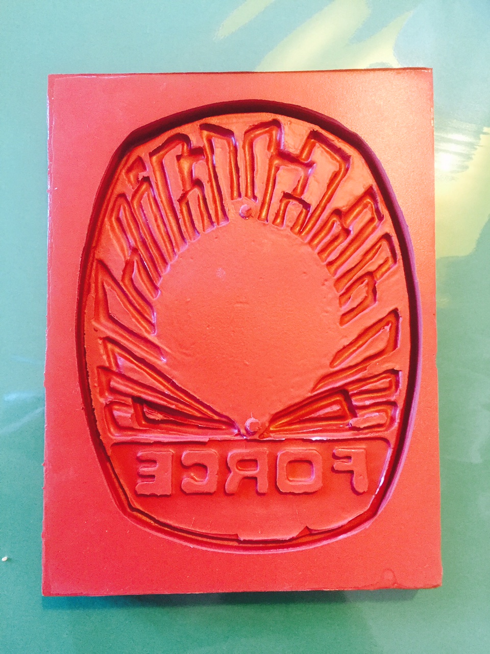

I made an impromptu vacuum chamber using a tupperware box and a vacuum cleaner... Didn't really think it would work, but it actually did... Bubbles came to the surface right away!
I let the casting cure on a reptile heat mat for 48 hours before demoulting....
Result is even better than before....
Even though it has a bit of tear near the bottom I'm going ahead with this mould and will try to do the pewter casting... I can always do a recasting if I'm not happy with it Very Happy
The mould needs to be baked for 2-3 hours at 150 degrees C first....

First pewter casting done! Result is better than expected Very Happy
The casing funnel got casted into the badge, well, rookie mistake... But only one little detail is missing in this first take (lower left part)... So I'm optimistic!
The german silicone is really a great product!

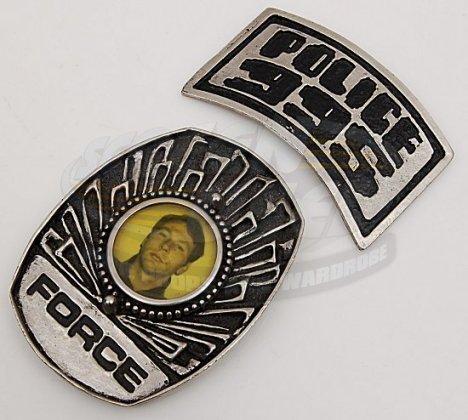

Ok, guys, I need your opinion on HOW the "flames" on the original badge were done...
Lukafilm used (IIRC) epoxy glue mixed with powder to a paste, then drew the them with a piping bag...
I used epoxy putty and molded tiny strings which were applied...
But the outer edges of the flames on the original badge are sharp....
Could they have been made using a negative mold where the flares were pressed into the backing?!?
Any ideas???
