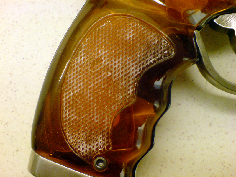

Tried the polish method. Looks okay but I need to add more. I did try white paint but I just couldn't get the right amount to be left behind in the grooves. with both methods I just can't seem to get an even amount left all over so it looks a bit patchy.
Also re-pained and weathered my grip frame. Notice the 'kidney' shaped hole has been filled in.

phase pistol wrote:
Hm! So you think that's what is on the hero prop... plastic polish residue? Shocked
My theory is that its either polish residue, or the plastic being cut when they put in the grip pattern, or a mix of both.

The polish residue wears away too easily even in the grooves believe it or not. No way it would still be there today.
Maybe the chequered part of the grips was painted white and its worn off the high spots. I don't suppose there are any photos from filming that show white there?
The Loyalizer wrote:
PostPosted: Wed Apr 08, 2009 9:29 pm    Post subject: Reply with quote
I tried the scratch method, by scratching the inner part of the pattern with an X-acto blade to simulate the checkering tool and it actually seemed to emulate the look pretty well. I think it is very likely that these are the master grips that were checkered into colored plastic/acrylic, and then ground and polished. if you combine the texture of the cutting tool, with any possible leftover polish, and a bit of drywall dust stuck into that I think you have exactly the right mixture for this look.
