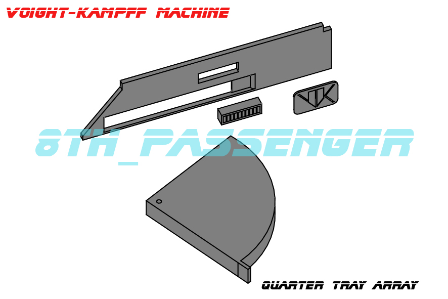

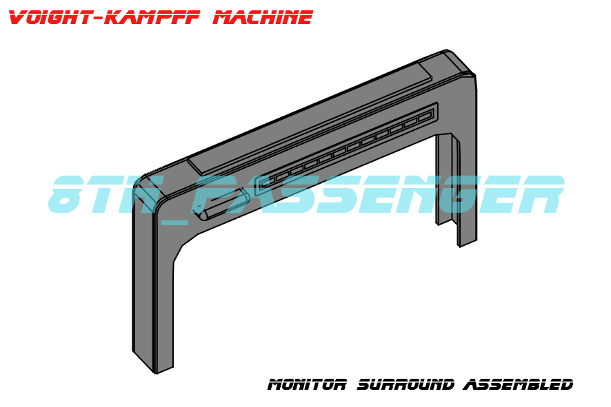

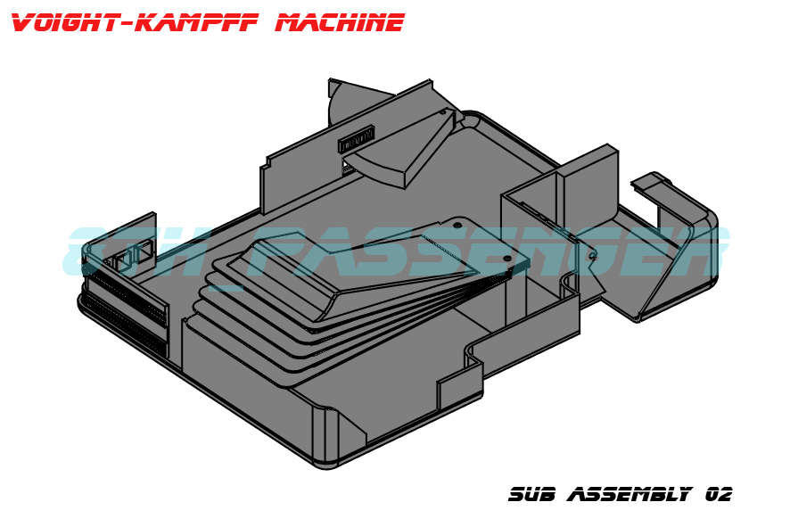

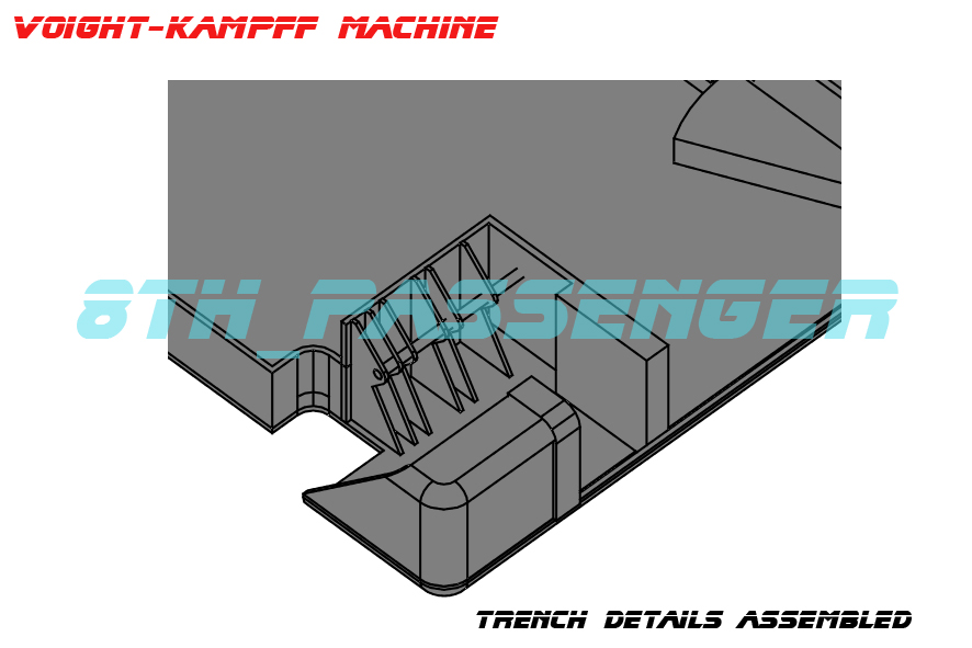

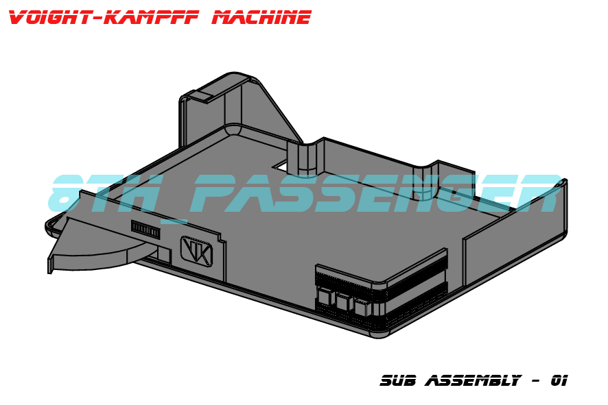

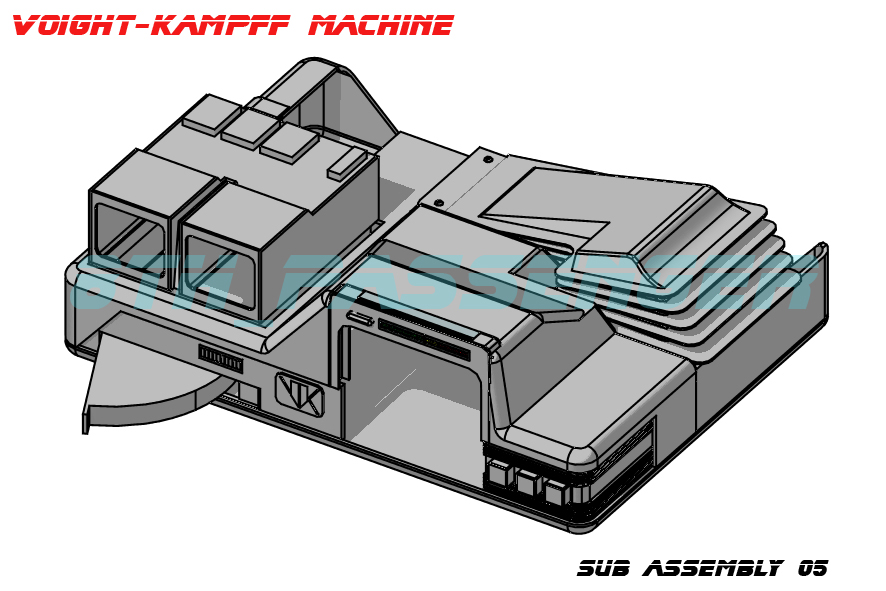

Posted: Sun Nov 19, 2017 4:09 pm Post subject: |
I've now drawn up a new set of plans based on the Propstore plans, at the magic width of 430mm wide!
It was hard to get the photos of the elevations to match up in photoshop. So I had to do some creative guess work.
The images that follow are really a rough guide for me in how I might approach making the VK.
There will be more understructure to lock the upper housing to the base etc and an internal plate to bolt the mechanics too.
I have no monitors so really I have no idea if anything will fit. But its a start.
Hopefully the steps are self explanatory.
Colin _________________ Ripley: What's it key on?
Ash: Micro changes in air density. |
Posted: Mon Nov 20, 2017 7:58 am Post subject: |
Looking very good Colin The way you did it, it looks a lot like a regular kit you could put together easily.
I discover new info concerning the trench: there's 5 little fins at the bottom of said trench also.
These are actually separate from the main ones that are against the left hand side of the trench wall, when you're facing the rear of the prop.
They look like small triangles; the lowest point of said triangle going toward the point of the main fin. The highest point toward the right hand side of the trench. Maybe the highest point is 1/4 inch high and is rounded.
I hope it's clear...let me know and I'll draw something for you  |
